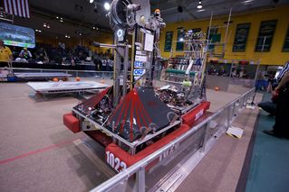

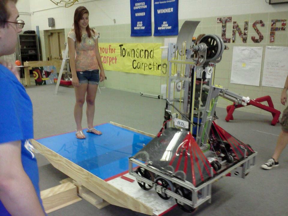

Debbie 13-07-2012 14:28
Re: 2012 IRI Scouting
1023 has added a locked set of wheels between our driving wheels to help with the triple balance. We seem to be best of the front of a triple, but can do other spots as well. We are wide and can now hang our front wheels off the bridge. We do have a stinger to help the balance. We have multiple hybrid modes with our most reliable being to shoot 2 in the top basket and then drop the coop bridge. We can also shoot reliably 1 from the side (sometimes 2) and knock our own bridge down. We are looking forward to seeing you all soon at our first IRI event! :)
Now...
Then...
http://i80.photobucket.com/albums/j1...023hang2sm.jpg
http://i80.photobucket.com/albums/j1...ebalance-1.jpg
http://i80.photobucket.com/albums/j1...10234003sm.jpg
