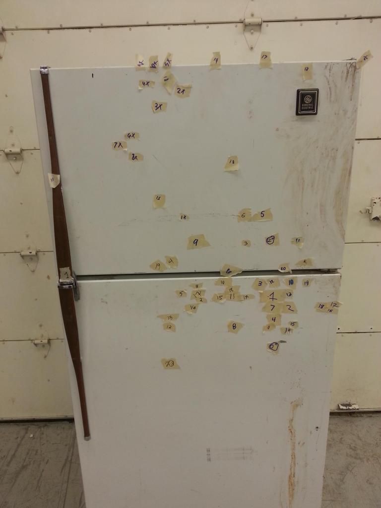

Originally Posted by nathan_hui (Post 1213472)
Also what would be nice is to see pics of the prototype used, so that we have an understanding of the exact conditions of the experiment.
http://www.youtube.com/watch?v=ThZCOtjVJmw for a video of our shooter.
Enlarge the picture by clicking on it. You can see the different results via different colored markers or an "X" on the tape.
An X indicates 8inch rubber w/ rubber tread (plaction)
Black (lower left) indicates 8inch rubber w/ rubber tread (plaction)
Blue (lower right) indicates 8 inch Pnuematic
Image showing the results
nathan_hui 12-01-2013 00:20
Re: Prototype data
All I have to say is... okay...
Could you explain the numbering?
ehochstein 12-01-2013 00:22
Re: Prototype data
I edited my previous post with that info. Should be above the image. I am about 99% sure that the info is correct. I was in the other half of the room while this was going on.
nathan_hui 12-01-2013 00:28
Re: Prototype data
The spread's going the wrong way (it's 90 degrees to the ideal spread, which is a landscape oriented rectangle). I'm wondering if the feed was done by a machine, would the spread go down? Also, did the one dimple on the wheel make a difference (i.e. would a better made wheel have improved performance by a significant amount)?
Also, I hope these refrigerator targets weren't used in that hall with that trajectory - that would invalidate the entire data set.

Camren 12-01-2013 00:46
Re: Prototype data
Alright the all in on answering post
The test set up was a fridge set up 24' 9" away from the fixed shoot roughly at 35 degrees from the table that was standing up about 2 feet from the ground.
Spread was determined based off of an point of best fit. then from the point we measure out to the farthest up, down, left and right hit.
Why is there not higher rpm pneumatic wheel test: First reason the wheel in my opinion one wasn't balanced and two didn't have the right fit to the bead, causing lots of vibration and for safety reasons we cut it off at 3500 rpm. Secondly we were happy with the accuracy of pneumatic wheel at 3500 rpm. the 80 rpm test on the treaded wheel came about after an odd spread at 3500 rpm.
In addition to Evans posts above the 12" and 0" circled were benchmarks to see how it would fly into the 3 point goal.
