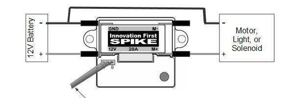

If you want to continue using the Spike Relay and just stop it from reversing the polarity. You simply need to modify your PWM wire.
1. Cut the Red/Middle wire, leaving ~2 inches of the wire on the Relay side.
2. Cut the Black/Ground wire at about the same place.
3. Strip the red wire on the Relay side, and both of the Black ends.
5. Put heatshrink on the long black wire, and solder the three ends together.
6. Slide heatshrink over solder joint and apply heat.
The M- pin will now always be grounded, and by setting the relay forward/off in the code you can change M+ to +12v or GND, however if you set the relay to reverse, you will get GND on both pins because the middle pin is still pulled to (-).

...or, of course, you can just *ground* the wire instead of connecting it to the spike. That is, just use one side (M+) for power and connect the other wire directly to the PDB.
Naaaah...too simple.:p

Al Skierkiewicz 29-03-2013 07:07
Re: DC-DC voltage converter for flashlight
Originally Posted by gixxy (Post 1254150)
Although I don't think grounding to the PDB will work unless you put it on a socket that already has a load on it, which I don't think is allowed (one wire per wago).
The black terminals on the PD are always connected to the negative terminal of the battery even if there is no breaker in place.
Doc Wu 05-04-2013 12:07
No need to cut up a Pwm cable, just wire your load like this.
