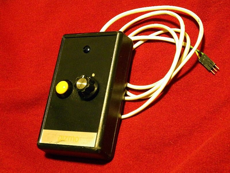

electroken 10-12-2015 06:20
Re: The Pulsinator is Here!
This is gizmo, The Pulsinator's weird uncle.
Devices like this are pretty handy when the programmers aren't letting us near the machine.*
*because we've given them two hours to program and debug the thing.
