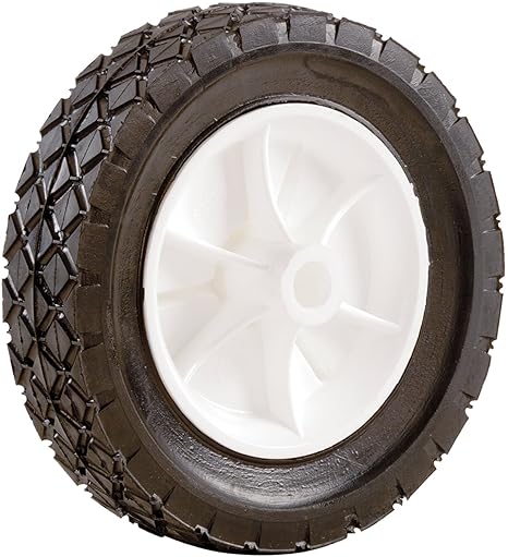

What are your thoughts on THESE wheels? The downside of the rubber threaded wheels on AM is that they are only an inch or so wide, potentially requiring two (side by side) to attain the required width for a tennis ball. These Vex wheels come up to 2.5", however with a lower diameter.

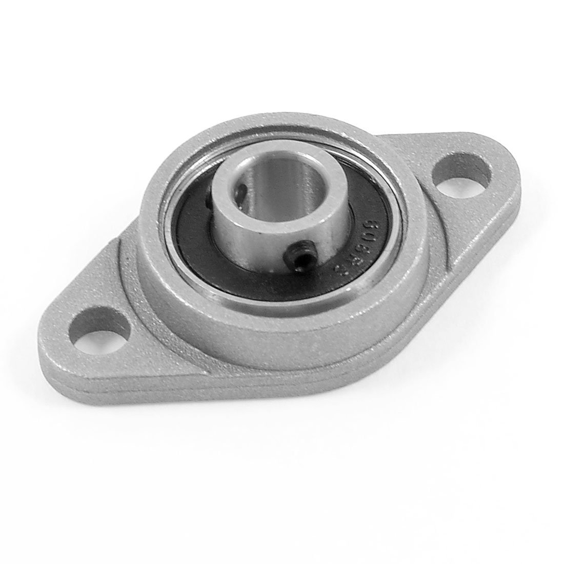

Can anyone comment on the bearing and housing needed on the other side of the wheel that will attach to the frame? I'm not super familiar with them, and what exactly I need. Will something like in the photo above work?

You could use that, or just drill a hole in the side and stick a ball bearing in with some locktite. That might be cheaper, although using what you show above might work too.

You will sacrifice speed with smaller diameter wheels and they don't have to be as wide as the ball. The ball just needs to hit the center of the wheel. Two side by side would give better accuracy but this application doesn't require it so a physical constant that keeps the ball mostly centered as it hits the wheel would be enough.
My suggestion would be to mount the 8mm hub to this wheel and on the other side use a 3/8" hub with this bearing at the end of the shaft.
