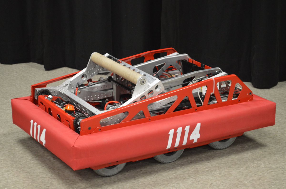

Team 1114 - Simbot Sentinel
Team 1114 proudly presents our 2016 robot, Simbot Sentinel
Thanks to all of our sponsors for their generous support, especially Innovation First International, General Motors of Canada, Gridpath Solutions, Juice Matters, Industrial Encoder Corporation, and The District School Board of Niagara.
Also, thanks to FIRST Robotics Canada for providing all Ontario teams a fabulous set of regionals. Simbot Sentinel will be competing at GTR East, Waterloo, and the final single FIRST Championship event.

It's all about that bumper quality.
New Lightning 08-03-2016 22:41
Re: Team 1114 - Simbot Sentinel
This looks like you have a roller intake that back loads onto a catapult. Since you are the team that you are I assume that intake doubles as a CDF and Portcullis manipulator.
But is there a climber secreted away somewhere there that I just can't see. And what about the Sally Port and the Drawbridge?

Monochron 09-03-2016 01:10
Wow, I'm surprised by the way it looks. All that square and rectangle tubing looks more like a 1678 machine :D
The wheel spacing really has me surprised though. Maybe they are just planning to never take the moat slowly. I really want to see this thing play.
If only the picture had a couple more pixels we could really dig in to some of those insides :)

A few more but still not that much

I'm willing to bet someone a whole dollar that the roller is definitely a kitchen rolling pin. Also, no idea what that bolt circle on the close end of the roller is doing...

Too much bent sheet metal, not enough polycarbonate, it does have at least one piece of wood however. Sufficient levels of rectangular tubing.
Agree with more pixels, love me some pixels.

i have a feeling that is there to hold the bearing in instead of a collar clamp and longer amount of (heavy) hex it also makes it much easier to to pull out the hex shaft and replace the wooden roller
They look like rivets holding the bearing in.
pilleya 09-03-2016 02:45
I don't really think using rivets would be very good for easy maintenance and replacement of the roller. It's a bolt

I'm very eager to see Simbot Sentinel competing at GTRE this weekend! Making guesses, but I see what looks like...
- ~32" long x 24" wide frame
- 6WD with 8" Pneumatic Wheels... hard to see anything for the drive gearboxees
- Short utility arm for 1) harvesting balls, 2) loading shooter, 3) operating CDF and Portcullis
- A scaling mechanism that is a two-stage arm. May use gas springs to power hang?
I honestly can't tell what the shooter is... it looks like either a wheeled shooter, a catapult, or a shooting mechanism on an arm (similar to 846 and 1690).

Is that versaframe :ahh: :yikes: ?

Sally Port is easy with that robot and a skilled driver - I saw 11 execute a similar (in terms of profile) design and consistently get the Sally Port without assistance at MAR Mt. Olive. Basically what happens is you go backwards through it, spin around 180 degrees fast enough to lose contact, and then go back though. Similar for the drawbridge, though I'm not certain how that robot will keep it down - some have arms that extend out in front that retract for a fraction of a second and then come back down to hold it down.

You're probably right, I just didn't expect it (and so many?) when they already have a bolt and washer holding the bearing in. Is there a reason to also add bolts around the bearing to hold it more securely?

I guess that is a climber on the back there. They just deployed it in their practice match, but didn't have time to actually use it, it seems.
