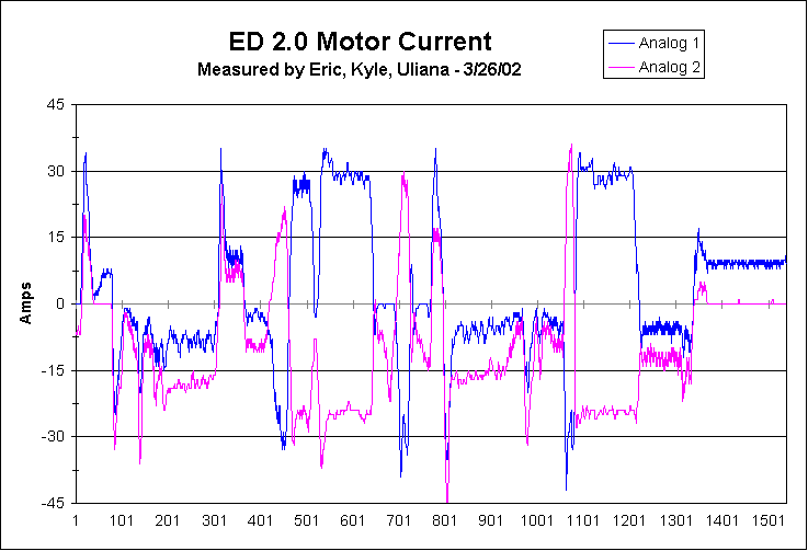

Current measurement results
Here are our results using the http://www.lemusa.com/ current sensors from Digikey on our old robot, which has 2 drive motors. (The current sensor is pictures in the center of their main page, standing on the triangle.)
I had to average each reading with it's nearest 4 neighbors to smooth out the graph.
The values for amps are only an estimate since we haven't calibrated the readings yet.
bigqueue 28-03-2002 16:39
Re: Current measurement results
Fantastic results! One question....what is the X-Axis time scale for those readings? (Seconds, milliseconds, etc...?) Is the total time shown over a two minute round, or are you saying the current varies that much over a short time?
Do you see the chopping (PWM) variations, and can you perhaps just filter them out with an R/C filter?
We filtered these out/down on our current measuring circuit.
Just a thought/question,
-Quentin
ECarlson 28-03-2002 17:00
Re: Re: Current measurement results
-Quentin
The timeframe was somewhere around two minutes, but it was just random driving around. I didn't time it, since my only goal was to get some data to plot. We'll run some more controlled tests later.
Each tick represents one log entry on the Dashboard 1.3 program. I don't know how much time that is per tick.
Yes, an RC filter would be good to smooth out the PWM pulses. Any suggestions for RC circuit values between the current sensors and the analog inputs?
I suppose if the output impedence of the sensor and the input impedence of the analog inputs were appropriate, I would only need a capacitor.
Al Skierkiewicz 01-04-2002 23:17
ECarlson,
Dave Flowerday and I have already written on our use of the Stangsense circuitry in the electrical forum. One of the big advantages we have in A/D in the circuit is the ability to integrate the results and multiplex up to eight motors into one stream. Additionally, the use of current monitor on the input of the speed controller is unipolar (only flowing in one direction) and measures the exact load presented to the circuit breaker.
In either case you can see from your data (even after averaging) that instantaneous currents are pretty high. We can easily see from the graph you posted when you turned obviously using tank drive (one motor turning in the opposite direction of the other motor.) and more interesting is the higher current being drawn by the "blue" motor. If you were driving straight I would look to a tight transmission on that side or a misaligned wheel. Have you tried plotting the battery voltage against the currents yet?
Good Luck,
ECarlson 02-04-2002 11:02
Thanks for the reply. I have the battery readings, but I have not yet plotted them.
We also need to do some test under more controlled conditions to really see what is going on with our old robot.
