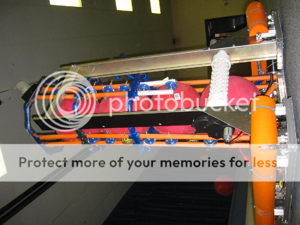

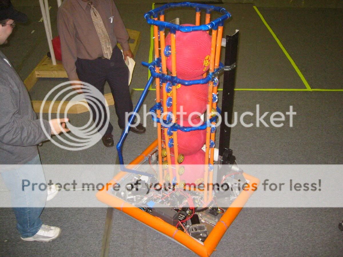

I'd like to introduce Evette. <Beauty pagent announcer> She's a holonomic ball collector who likes short autonomous routines that knock off tee balls. When she's lonely, she likes to snuggle up with a mobile goal. She also enjoys uncapping short and tall goals. </announcer> She goes 11 fps and can hold 4-5 balls at a time, too!
<wolf-whistle> that evette sure is a looker!
how are you uncapping the goals? also, are you guys hanging as an earlier rendition showed?

Nice! Is it very quick on picking the balls up off the ground?

yeah it is, we modified the fisherprice motors by taking out the last gear in the system, so they run about 3 times faster than the regular fisherprice. Then there is a 3 inch roller on that.

How is your drivetrain? From the looks of it the entrance area for a ball is just wide enough to get it. Without a good drive system, you might run into issues actually getting the balls into ur corral.

well they have an omni holonic drive there.. so I imagine their drive is pretty good

We removed the hanging mechanism. Not because we were overweight, but because we felt we were overcomplicated. Plus, with all the hangers out there, we feel that it'll be pretty hectic up there already.

None of our pneumatics are plumbed yet. That includes the goal grabber, tee knocker, and 2x ball descorer.
