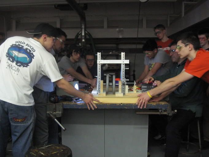

Team 1676 had a prototype 1 shooter! :yikes:
~ kit bot wheels
~ small sim motor
~ 1:1 gear ratio
~ Approximately 2000 rpm
~ 1.2 inches of ball compression
Results:
~ Really far.
~ Really fast. :D

EDIT: hey spiffizzle... keep going on that design. it looks really nice so far.

Cool! We are at the same step, except we went thru the prototypes 5 times..
Our structure was built out of the kop frame materials.. *SHIVERS*
We started with one KOP gear box, followed by two, followed by a repositioning, followed by using a drill motor.. THEN finally using the exact same set up as the one in your picture XD, except with 1 wheel.. Then we tried it with two... then...
._.;; hopefully we'll be able to finish our real launcher instead of playing around with those stuff.. :)
We are way behind.. T_T
