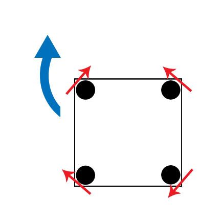

The idea is that the chassis will rotate about the point where lines, drawn perpendicular to and from the center wheel on each side, intersect. This is true of how traditional tank-steer robots operate as well, except that they typically lack the ability to move that point as this design allows.
Typical drives can spin in place because, by moving each side opposite the other, the translation vector of each -- that is, the force that would move it forward or backward -- is cancelled by the other. When each side is no longer parallel with the other, some of that translation escapes, as it were, and the chassis starts to behave as an inefficient holonomic platform. Thus, running each side in the 'opposite' direction will result in sideways translation. Driving them in the same direction will result in forward or backward movement. The only exception would be when they sides are again parallel, but collinear, as would occur when opened 90*. In this instance, driving them in opposite directions would do nothing at all (except break your robot, perhaps), while driving them together would result in the most efficient sideways translation possible because you've effectively changed which direction represents 'forward'.
Without a fixed point about which to rotate, all this design seemingly allows is a way to vary the efficiency at which a holonomic platform operates. That's not without merit, necessarily, but it doesn't seem to me that it would work as advertised. All of this assumes, of course, that it uses omniwheels. Other wheels would effectively function the same, but it would be even less efficient.

....The 4 wheel mecacum design seems better because it will always be omnidirectional and still be able to travel in an arc....
Here is a thought starter;
Imagine a traditional mechanum drive arrangement. Now imagine it translating sideways, except that the rotational velocity of the front 2 wheels is less than the rotational velocity of the rear 2 wheels. Wouldn't it have exactly the same motion that your trying to get?

I agree with what has been said a few times, that an idea along these lines might be cool for non-FIRST purposes. But for FIRST, I think it invests too much weight, spaces, motors, and compelxity (especially for either the driver and/or programming). Secondly, it would do as Madison suggested, and perform similar to a holonomic system (which could be beneficial in other ways).
There are other ways that your desired arc could be achived. The mecanum suggestion earlier is one.
Another could be a standard holonomic drive.
By moving the wheels as such (with the "NW" and "SE" wheels driving at different rates) you can acheived the desired arc motion.
