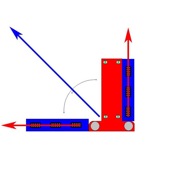

OK here it is: it is a regular four or six wheel drive, except that each side of the drive train (the blue parts) would splay out to allow driving in arcs. Depending on what angle you expanded them to, you would drive in a larger or smaller arc; If you expanded them to 45*angle, you would travel in a mid-sized arc, and if you expanded them to an 87* angle, you would travel in a very large arc.
There would be a platform suspended on casters between the sets of wheels (the red part) for mounting any mechanisms that you needed to.
The top "diagram" would be fully closed, which would allow you to drive normally; and the bottom one would be fully open, which would allow you to drive sideways.
Am I missing anything that would make this not work?
P.S. I apologize for using paint, It's all I have at the moment. :)

Wouldn't the casters drag on the floor/carpet while you are moving sideways?
Oh yea and how are you going to program that thing to go sideways? when hinges are closed it can go forward and backward but when you open the hinges and wheels are 180 degrees, wouldn't each side try to fight against each other?

I'm having trouble convincing myself this would work. Specifically, the omnis are blowing my mind at this point. I know the theory behind them is always that they sideslip to make turning super easy, but they also end up getting pushed side to side. The one arrangement I can sort of envision is when your hinges are at 45 deg and the sides are now perpendicular to each other. If just one side moves, the opposite side will side-slip and it'd end up going that direction. So I'm skeptical it'd do exactly what you think it will in that arrangement, and thus I'm not entirely certain about any other arrangement.
It's still an interesting design, though.

I don't believe that the casters would cause a noticeable amount of friction.
Now, for programming it to go sideways, you could just program it with tank drive and make the x-axis on the joysticks move the robot side to side when it is open.
Hmm...The omnis were originally just so that you could open and close the sides without an extremely strong motor. If you replaced them with grippy wheels, it would just take a lot more power to pull the wheels sideways when opening or closing the wheel-base.

I was thinking grippies just at the middle or closest to the hinge. It would certainly do exactly what you want with a single grippy on each side.

Just an idea, if you replaiced the omni wheels with mecanums, wouldn't you be able to move back and forth as well as side to side?

Mechanums would theoretically give you full range of manueverabilty even with the wings fully swung out, albeit with reduced speed in most directions. I must admit that the code for mixing a joystick signal to appropriate motor signals at any amount of swing out would be a headache I wouldn't look forward to, but you would have just about the coolest drivetrain around if you pulled it off well.

OKay, I see one glaring problem. What's stopping another robot from planting itself next to you and stopping you from opening up your "wings?" I mean, that would be a good defensive strategy against a robot of that nature.
There was a robot, I think it was 930 in 2005 that opened up like this but I'm pretty sure it was for a different reason.
Also, how much do you think this set-up, as you have it now, base only, would weigh? Looks pretty heavy.
But nonetheless it's a very interesting idea. I'd like to see it a bit more.
/Edit: If you used a two-wheel crab drive, wouldn't you just be able to turn the crab and that would open itself up? Turn the wheels to X degree and drive the wheels. This would cut down on some weight I think and just hinge the wings. And then you should be able to move side to side, in an arc, and forward/backward with less weight than the mecanum.
I was thinking the same thing. However, What if the "hinges" were in opposite corners, the center of each side, or even if there were more than two hinges? While I, too, would wonder if the complexity gives you a distinct advantage over other designs, this is certainly inventive and interesting.

As far as the rule <R08> goes (after the start of the match the robot may expand up to a maximum volume of 60 inches by 60 inches by 60 inches)... there have been teams who have made their base shorter than 38x28 (bot had riggers and so forth but after full extension they were in the size limit). The problem Ben pointed out earlier is one of the very important component of this design (if you are building this chassis for a FIRST robot according to last year's rule) but there are ways to avoid the chassis extending more than 60". I do agree with you Ben where you said it's a very complex design, but how cool would it be to see something like this on a FIRST field.
(I'm quoting Kevin as a starting point, not because he's wrong. He's not.)
The idea is that the chassis will rotate about the point where lines, drawn perpendicular to and from the center wheel on each side, intersect. This is true of how traditional tank-steer robots operate as well, except that they typically lack the ability to move that point as this design allows.
Typical drives can spin in place because, by moving each side opposite the other, the translation vector of each -- that is, the force that would move it forward or backward -- is cancelled by the other. When each side is no longer parallel with the other, some of that translation escapes, as it were, and the chassis starts to behave as an inefficient holonomic platform. Thus, running each side in the 'opposite' direction will result in sideways translation. Driving them in the same direction will result in forward or backward movement. The only exception would be when they sides are again parallel, but collinear, as would occur when opened 90*. In this instance, driving them in opposite directions would do nothing at all (except break your robot, perhaps), while driving them together would result in the most efficient sideways translation possible because you've effectively changed which direction represents 'forward'.
Without a fixed point about which to rotate, all this design seemingly allows is a way to vary the efficiency at which a holonomic platform operates. That's not without merit, necessarily, but it doesn't seem to me that it would work as advertised. All of this assumes, of course, that it uses omniwheels. Other wheels would effectively function the same, but it would be even less efficient.

I see one big flaw in it... when the bot is extended out for side-to-side motion (Crabbing) it is totally vulnerable to being pushed back and forth because of the omni-directional wheels. I think the drive train design, while pretty cool and original, would be so poor defensively that it would be almost useless in a FIRST game.

Arefin Bari 18-08-2006 21:20
Re: A new drivetrain Idea?
There are few posts in this thread that just explains how this idea would never work and how other kind of drive trains will work better (basically asking him to give up on this). I think that is pretty obvious that this design is in the very early stage, and it definitely has some potentials. Has any of you seen a drive train like this before? Team 47, Chiefdelphi designed the first swerve drive and over the years teams have come up with stronger swerve drive. I bet one of the robots could have pushed around chiefdelphi's first swerve drive easily at that point but it has been developed and modified by many teams over the years. Rather than telling Cody that this idea would never work, why not help him and give him ideas about how to make this new idea a reality?
Are there people here who wants to think outside the box and come up with new designs that has never been done in FIRST?
Keep in mind the first transmission I ever designed weighed 13 pounds, the second one I designed weight weighed 5 pounds. Designs can be reviewed and modified for the better. I am going to propose to all the chiefdelphi designers to come out here and post how can this design become a product. Thank you.
Cody Carey 18-08-2006 21:41
cromat44 is exactly right about the kind of advantage I was originally looking for, although some people have mentioned a couple of others that are now seeming VERY interesting to me. Please don't take the drawing with the omni-wheels as set in stone... because as Arefin or Tytus have said, It is more a way to get my Idea across than an actual design. I'm taking into consideration everything that everyone is saying, and I just don't get how this wouldn't work. When coming up with this Idea, I was mainly thinking of roller blades or Ice skates, and how the athletes that wear them turn in arcs; it seems to work for them... I will try and build a prototype tomorrow or the next day. Until I can do that, please continue as you are.... I find this VERY helpful :D
P.S. Sorry if I don't have the Prototype tomorrow, I have to go to a wedding.
P.P.S. Thanks Arefin and Tytus:D

Lil' Lavery 19-08-2006 15:31
The reason I don't beleive the design, as you have presented it so far, would not achieve the desired result is that it doesn't work like the skates you envisioned. In the example below, if you drive each "wing" at equal value, the resultant vector would be 45º between the two.
I think a design like yours could be acheived, and do some exciting things, but the way you have it currently wouln't work sucessfully.
MikeJ675 19-08-2006 16:01
If either(but not both) of the pods had the drive direction reversed, it would turn in an arc.
Madison 19-08-2006 16:39
No, it wouldn't. The resultant vector would be pointing 45* into a different quadrant is all. Reverse one of the arrows Sean drew and do the vector addition again and you'll see that, without a fixed point about which to rotate, this is nothing more than one half of a typical holonomic platform. If y'all were to build this and it did travel in some sort of arc, the only likely reason for that to happen is because of inequalities in the operation of each side of the drive. The efficiences losses won't be exactly equal, so there's some chance that, given equal power, the component vector of each drive side would be slightly different.
Cody Carey 19-08-2006 17:29
What if you didn't use omniwheels?
Kevin Sevcik 19-08-2006 18:41
I've decided I don't buy this. If figuring this out were as simple as adding the force vectors like you and Sean do, then I'm forced to conclude that a standard 4WD omniwheel setup can't turn. If I do your style of vector math when I drive one side forward and the other side back, I get zero and the thing doesn't move. This is patently false.
"Where's the problem, then?" you ask. Well, the forces aren't being applied through the center of mass of the robot. As this is the case, you should end up with a residual torque that will turn the robot as it translates to the side. Viola! You get an arc. However, the centerpoint won't be wherever some perpindiculars from the sides intersect. It'd depend on the center of mass of the robot, and probably a host of other factors. So, even more confusingly, it would change slightly if the CoM of your robot changed from, say, emptying a hopper full of balls.
There, I went and thought about the physics of this. On a weekend no less. I hope y'all are proud of yourselves.
Madison 19-08-2006 19:01
That's right. The center of gravity would represent the fixed point of rotation. Holonomic platforms have two more drive sections and those cancel the torque applied to the robot's center of mass when driving in a straight line. Because this design is asymmetric with respect to that center of mass, it will apply some torque and travel in an arc. Opening or closing the wings, however, will not vary the radius of that arc any more than it moves the center of mass along a line that bisects the angle between the wings. The drivetrain ought not represent more than, say, 15% of the robot's weight as far as I'm concerned, so you wouldn't likely see a notable shift in the center of mass.
While I certainly don't want to rain on anyone's parade and I think it's valuable for students to be entertaining and developing interesting ideas, it's also as important for them to understand what's happening to make them work and to understand the similarities between their ideas and existing technologies. It's not always fun to use what's already available (and I often don't), but sometimes doing an effective cost-benefit analysis is as valuable as implementing a new spin on an old idea.
It seems to me like Cody's been trying to examine the function of technologies like holonomic, mecanum and swerve platforms and distill from those the bare necessities that make them work. That's an awesome goal and, while there certainly are some really bloated examples of these designs, there are equally as many with important, functional features that aren't apparently obvious at first examination. Starting a design with the minimum functionality desired and working through its problems is a fantastic way of seeing how and why others have added in certain features.
Karthik 19-08-2006 19:20
I'm slightly disturbed about the amount of half-truths being purveyed in this thread. I suggest that before making assumptions about the type of motion that a given drivetrain can achieve, you should follow Kevin's lead and review the basic kinematics and vector mathematics that goes into the actual calculations. As aspiring engineers, you should be moving past the "I think this will work this way because I think it will" and moving on to "I know this will work this way, because I've done the calculations to back it up".
For those of you who have yet to learn about these types of calculations, here are some great resources:
http://en.wikipedia.org/wiki/Vector_%28spatial%29
http://en.wikipedia.org/wiki/Kinematics
Once you've gotten a handle on those, take a look at Ian's whitepaper which discusses the calculations behind omni-directional drive systems:
http://www.chiefdelphi.com/media/papers/download/1855
With a firm background in linear algebra and kinematics, you'll find that questions like one's being posed about the arc like path, become simple and intuitive. Now, by no means is anyone expected to learn this over night, but I see a lot of energy and enthusiasm in this thread, and I have a feeling that a lot of you can digest this stuff on your own.
Remember, being an engineer isn't just about messing around in CAD.
MikeJ675 20-08-2006 03:00
I probably wasn't clear enough, as I was in a rush at the time I posted.
At 90 degrees it would turn in an arc, but a very tight one, centered around roughly the same point(the pods not being at the same distance from the effective corner will cause it to not be quite perfect, I think)
The wider the angle between the pods, the larger the arc would be.
One thing that may aid in controlling the arc is a 3rd/5th motor(depending on the design) in the front as the other point of contact. Controlling the speed and direction of the extra wheel should give you precise control of the length and shape of the arc.
