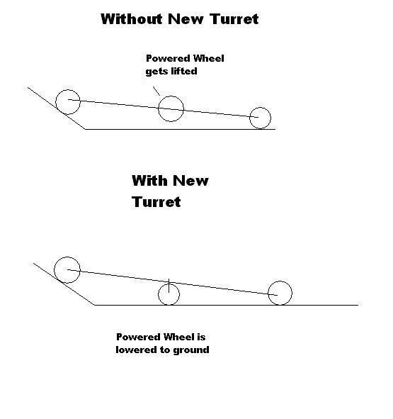

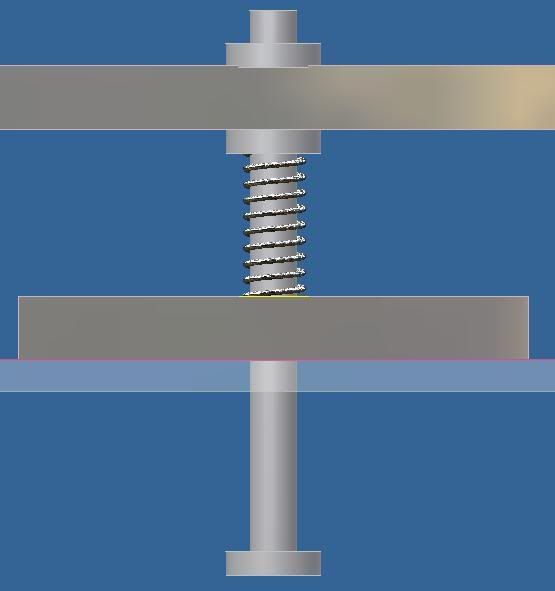

Originally Posted by rocketperson44 (Post 625184)
The redesign has a feature that should compensate for this. The turret looks something like this now.
The spring (if gravity isn't enough) will push the center platform down up to 3 inches when lifted off the ground by ramp or defensive robot
This may also require that the turreting mechanism be able to pivot relative to the frame, as well -- and the diameter of your turntable will still considerably limit the maximum angle you can climb.
Brandon Holley 07-05-2007 16:29
Re: pic: Unique drive concept
Great idea, i'll experiment with this when I make a prototype.
That was the plan for turning.
The spring (if gravity isn't enough) will push the center platform down up to 3 inches when lifted off the ground by ramp or defensive robot The result will look like this:
how about adding the suspension to the omniwheels at the corner.....saves some complexity dont you think?...
just give yourself enough ground clearance with the frame
