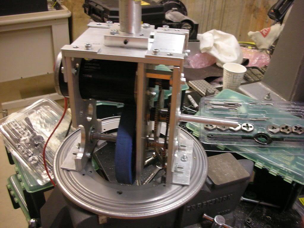

RMS11 05-09-2008 19:20
Re: Crab Drive
Here is a picture of our first module, which we have (finally) gotten to build. Everything works well so far. We have ordered parts for the other 4 modules, and we already have those plates cut. More pictures are at http://s296.photobucket.com/albums/m..._tab_my_albums
It is now about 7 lbs, we are hoping we can take off at least 1.5 pounds for the other modules. :D
Joe G. 05-09-2008 19:33
Re: Crab Drive
I am by no means a gearbox expert, but those gears look quite thin compared to many other gearboxes and Crab drives I have seen.
Any particular reason for that, other than weight? Sure they will work?
