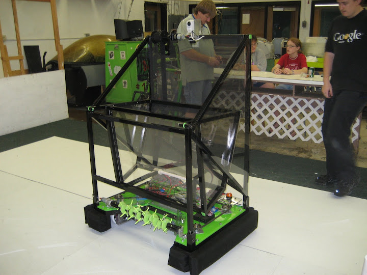

This year we went half way to wood, there is an aluminum angle/1x1 box tube exo-skeleton, but everything is mounted to the wood base (painted green green in the picture) including our crab modules. So far it has worked out great.
