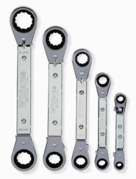

Bochek 31-01-2010 08:27
Re: pic: 1678 Teaser #1
My Guess, The rubber bands are for an anti back-drive mechanism.
Rion Atkinson 31-01-2010 10:23
You are missing one of the gears, so you obviously don't plan on using the shifting half. But why do that is the question... :confused:
EDIT: I just noticed that the other gear has been switched to something else as well. I'm going to go with Adam Bochek, an anti back-drive mechanism. Which would be great for hanging... :D

daltore 31-01-2010 13:41
I'm guessing you're using the dog gears from the super shifters for a ratcheting kicker mechanism? That doesn't look like something I'd want to sit in front of for too long.

sanddrag 31-01-2010 17:10
Are those ratchets and pawls from McMaster?
Akash Rastogi 31-01-2010 17:14
The McMaster ones run a little pricey. We bought 3 sets of the 3" ratchets and pawls for each. Its about 50 per ratchet and 40 or so per pawl.
Bottom of this page.

Michael Corsetto 01-02-2010 01:44
http://www.mcmaster.com/#gear-pawls/=5ma9na
And the ratchets happen to be 3/8" thick, which works out petty well :)

Ken Leung 01-02-2010 04:07
Ding ding ding! And David is the winner!
So, I am guessing you using these for a hanging winch or some sort. But why two? I have absolutely no idea.
Thankfully, they sell a lot of winches that has ratchets built into it, so we don't need to use ratchets and pawls in our gearbox.

Ken Leung 02-03-2010 03:30
Guess what I found at Sears on Sunday:
http://www.sears.com/shc/s/p_10153_12605_00942636000P
This guy is going on our robot this year (at least, I hope so).

Lowfategg 02-03-2010 11:57
Looks like a winch gearbox for kicker. The ratchet and paw are a nice touch. I used one on our leadscrew lifting arm to stop it from back driving as well.
Overdrive is using a very similar setup. Be careful with the stock shifting block and shaft they tend to destory themselves or explode. :D
Michael Corsetto 02-03-2010 16:17
I'll keep an eye on it. We have been kicking for a few weeks with no problems, and we have to use a 2" bore cylinder to pull the dog out :ahh:
