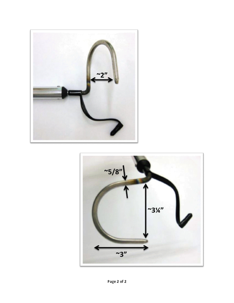

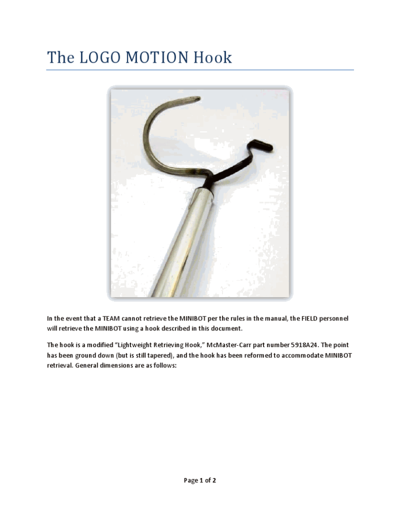

For emergency use, it is recommended that you put something that the Retrieval Hook can grab onto the Minbot. TU#7 addresses this; a design for said hook is out.
http://usfirst.org/uploadedFiles/Rob..._Update_07.pdf

For those unaware of the official retrieval hook. (Mentioned in the above PDF)
