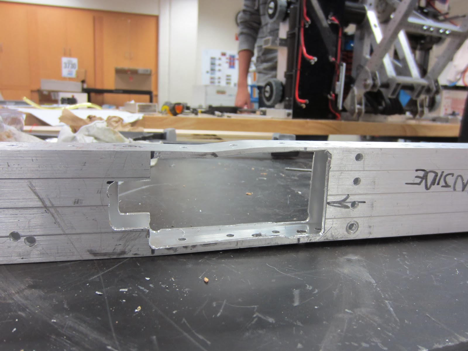

Yep. Here was a piece from our first iteration. We had left it slotted for flexibility in determining final geometry. The shock load on the choochoo from about 25% of our final bundle tension was enough to pull a 1/8" or so offset into our 1x2 VersaTube.
Pic
