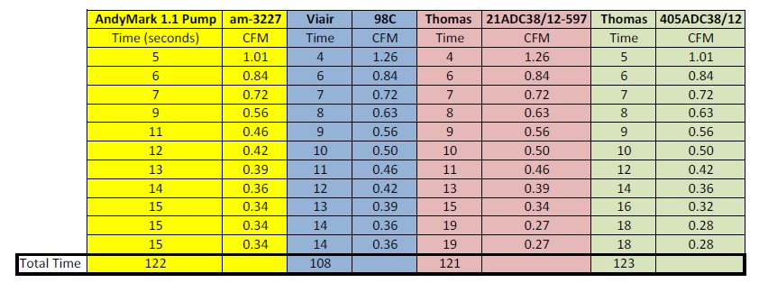

Re: 1.1 Pump (am-3227) Really an improvement?
Originally Posted by AllenGregoryIV View Post
Do we have any new pump data?
Yes, sorry it has taken so long. Here are results for a comparison between the AndyMark 1.1 Pump, the 98C Viair Pump, the Thomas 21ADC38/12-597, and the Thomas 405ADC38/12 pumps. I used approximately the same test as I did before in order to get these numbers.
Sincerely,
Andy Baker
