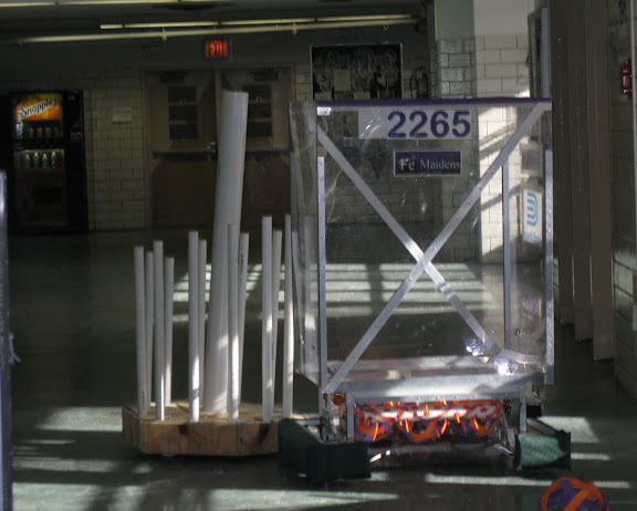

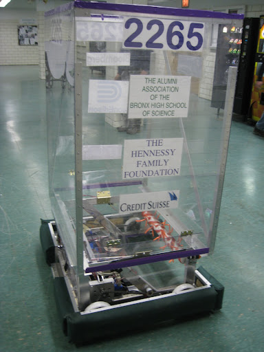

2265 The FeMaidens - 2009 Robot
Has:
23.5" long PVC pipe with "brushes" made from pneumatic tubing
Hopper consists of: 4 27.5 "-44.125" long .125" thick lexan pieces attached
by 1"-1"-.125" aluminum angle.
It can easily hold 60 balls with room for more .
http://lh5.ggpht.com/_YyEmCgTB2ug/SZ...2/IMG_2257.JPG
http://lh4.ggpht.com/_YyEmCgTB2ug/SZ...6/IMG_2218.JPG
