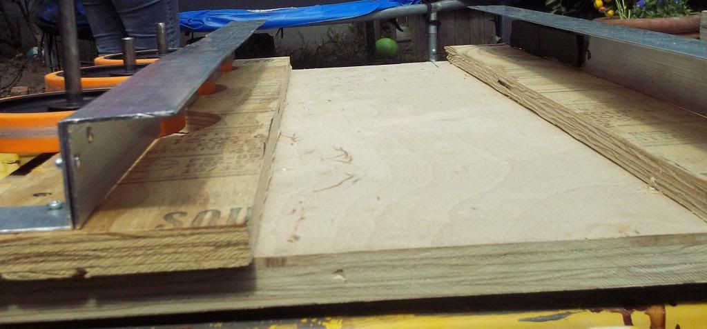

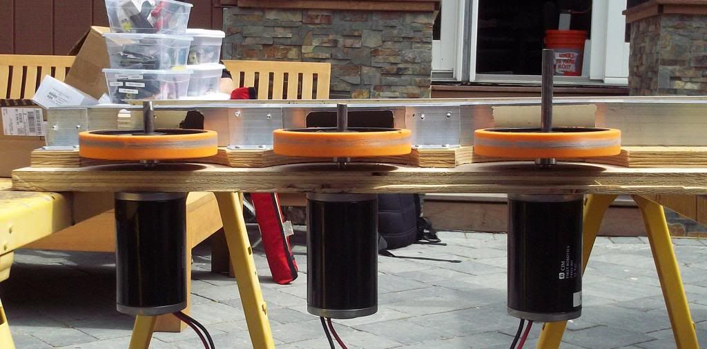

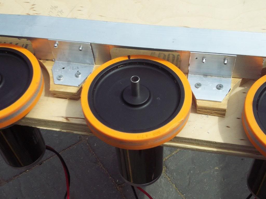

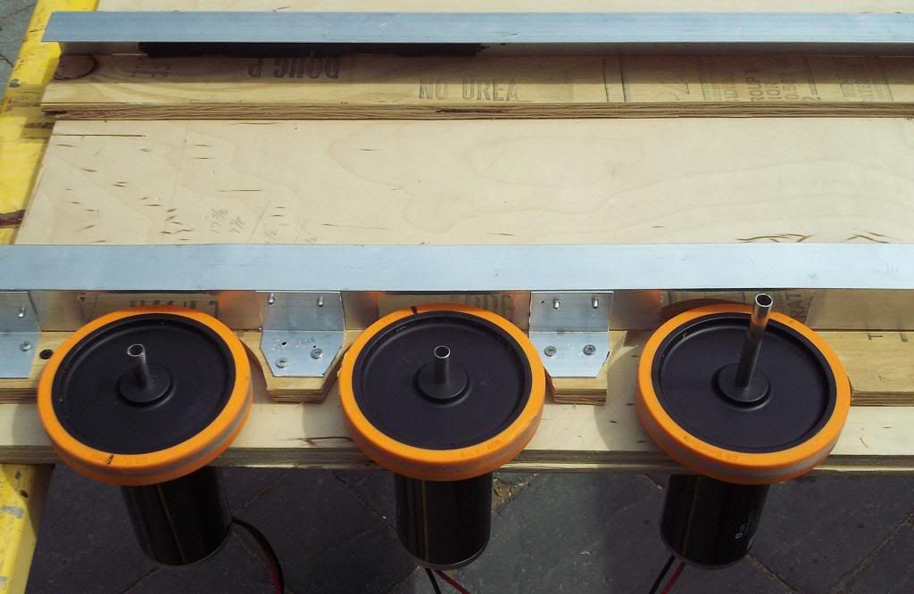

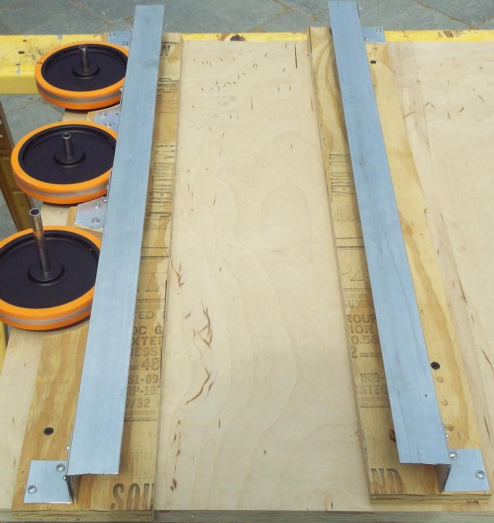

Hello everyone!
I've got photos of the shooter in question... here:
We're using CIM Motors, with no gearboxes, I'm not sure about speed, all of our electrical is inaccessible, so we have the motors linked directly to a circuit breaker and battery.
Thanks!

Re: Shooter Help for 2nd Year Team
It looks to me like your wheels aren't getting enough contact with the frisbees. Any chance you have anything else to show us? A CAD file? A video?
It may be that little compression (looks to me like .125-.25 at most) paired with immediate high speed is not enough to impart much velocity on the disc. Since you appear to have the materials handy, I suggest you look into a Spectrum (Team 3847) esque shooter. You would be able to sub the BAG motors for 2 CIMS, the smaller wheels for your bigger wheels, and also I suggest looking into slowing down the first wheel that the disc contacts.
Originally Posted by Thorne View Post
Hello everyone!
Thanks!
Several thoughts come to mind:
1) In the world of shooting frisbees with spinning wheel(s), you reach a point where faster is not better. In fact, some teams have reported a *loss* of frisbee exit speed once the wheel(s) were spinning faster than some experimentally-determined optimum point. So, it's hard to "tune" your shooter if all you have is an on/off switch for the motor voltage.
2) I don't see anything preventing the frisbee from riding up the side of the fence (the guide rail opposite the wheels). If that is happening as the frisbee passes through, you won't get sufficient compression
3) The fence looks shiny and slippery. You want more friction on the fence so that the frisbee has to spin its way through the shooter. Without adequate spin, the frisbee won't go far.
4) The wheels are narrow compared to the chute height. There's nothing preventing the frisbee from climbing up over the exposed part of the wheel.
1. Ask a local team for some hands-on help, there should be no shortage of good teams in your area.
2. From my measurements you have almost zero compression, we run our orange banebots wheels at 3/8" compression, but up to 1/2" works well.
3. I'm not sure how you are connecting to the CIMS, but I don't see any keys in there, are the wheels slipping on the shafts?
I'll do my best to reply to everything in order...
Here's a video: http://www.youtube.com/watch?v=e7zD_Qd1mG0 we've made some modifications since taking this video, and have dealt with some of the Frisbee jumping and slipping on the fence.
We've replaced one of the big CIMs with a smaller one, and will probably take off the third wheel...
As far as the wheels slipping on the shaft itself, we're using shaft collars with locking screws and the wheels aren't going anywhere.
These seem like your two best bets to me. In addition to this, add something sticky to the wall opposite the wheels.
And one more suggestion, playing with wheel speeds can help a lot. A variable voltage power source is ideal, but a poor man might try wiring the first two CIMs in series and the last one in parallel. Or, mini Cims spin at ~6.2k rpm to the CIMS 5k and have the same mounting and shaft size.
Try some different types of wheels as well. My team went through a few different sets of wheels to see which worked best. It turned out the same wheel we used on our shooter last year worked best for this year as well.
