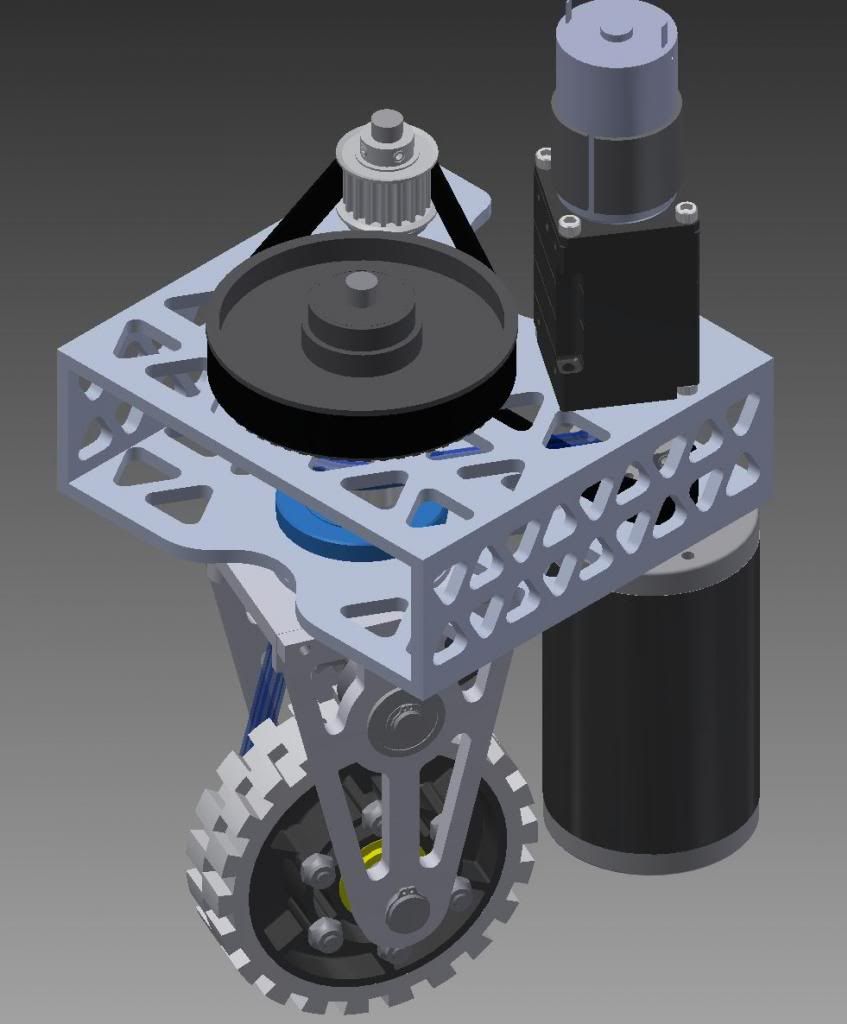

2 CIM Swerve Concept
Here's my attempt at designing a swerve drive. Any feedback/criticism/questions is welcome.
The weight per module is a little over 5 lbs without CIMs, with most of the weight coming from the steering motor/gearbox and the aluminum tube.

Re: 2 CIM Swerve Concept
Err, what might the benefit of two CIM swerve be over the more conventional one CIM?
I wanted to reduce weight by having only three modules, but I didn't want to only have the power from three CIMs. Also, because I have a lot of torque from two CIMs on each module, I can gear the module so that it is pretty fast, but can still do well in a pushing match.
With almost any wheel, you will run out of traction long before you run out of torque, especially with the wheels you show in the CAD

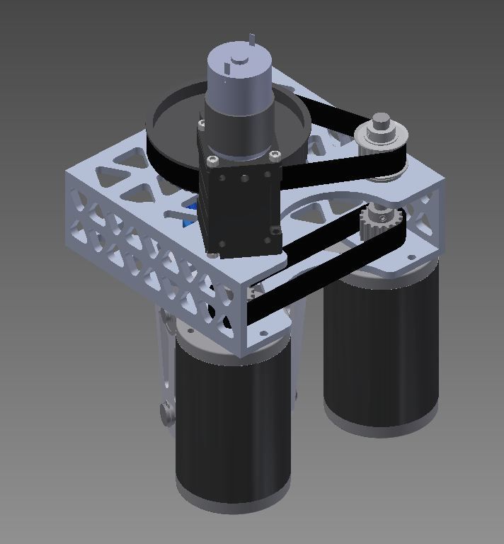

Am I understanding correctly that both CIMs drive the small pulley? How will you extend the CIM shaft all the way through the rectangular tube? A shaft coupling?

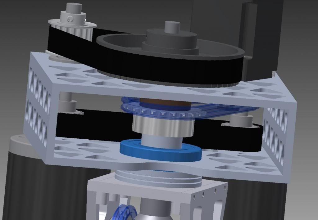

Yes. The CIM underneath the smaller pulley has an 8mm shaft coupling that connects to the longer shaft that is connected to the little pulley on top of the box. There is a bearing on the top of the box.
The original design was for a 1 CIM swerve, and I haven't made up my mind as to which one is better. I posted the 2 CIM version because it looks cooler.
...an 8mm shaft coupling...
The keyway in the CIM output shaft does not go all the way to the end (pdf link). You could mill flat spots in the shaft to provide landing areas for the set screws on your shaft coupling, but I'd expect this to be a point of failure.
Why might going 13fps be advantageous over 7fps? Have you found it advantageous, excluding 2008, to have a high top speed?
Originally Posted by Ether View Post
Here's a link to a PDF giving the equations for inverse kinematics for an N-wheel swerve, where N>2.
Thanks, this is really useful!
I agree, this is the weakest part of the design. In the original 1 CIM version, the CIM was mounted on the upper plate and there was a hole cut out the bottom part, so no shaft coupling was needed.
A better solution might be to take a large diameter aluminum shaft about 3 inches long, put an 8mm hole in the bottom for the CIM, use a CNC mill to make the pulley part on the bottom, then turn down the rest to a 3/8" diameter.
Alternatively you could try to move both CIMs up to the upper plate and route the belt in a triangle around the large pulley.
I tried that, but when I did that, the belt calculator showed that only 2 teeth of the belt would be engaged.
