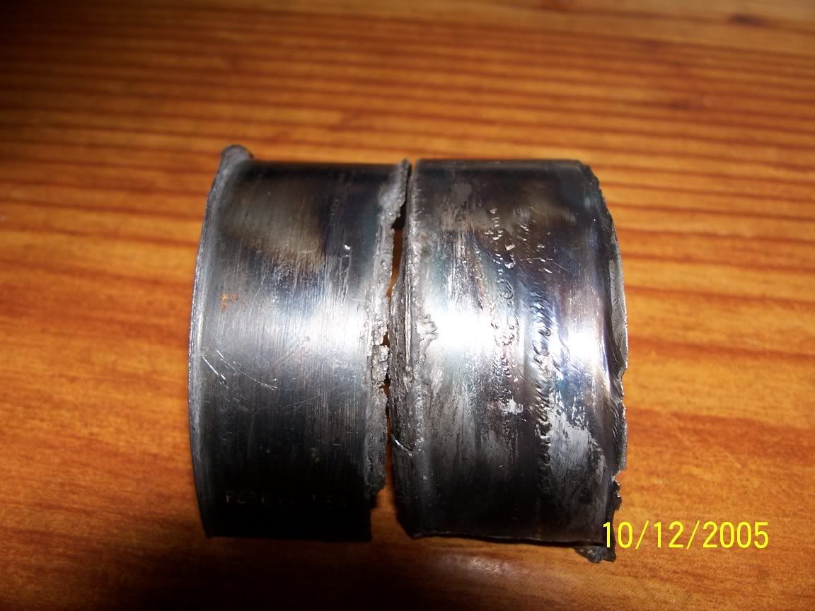

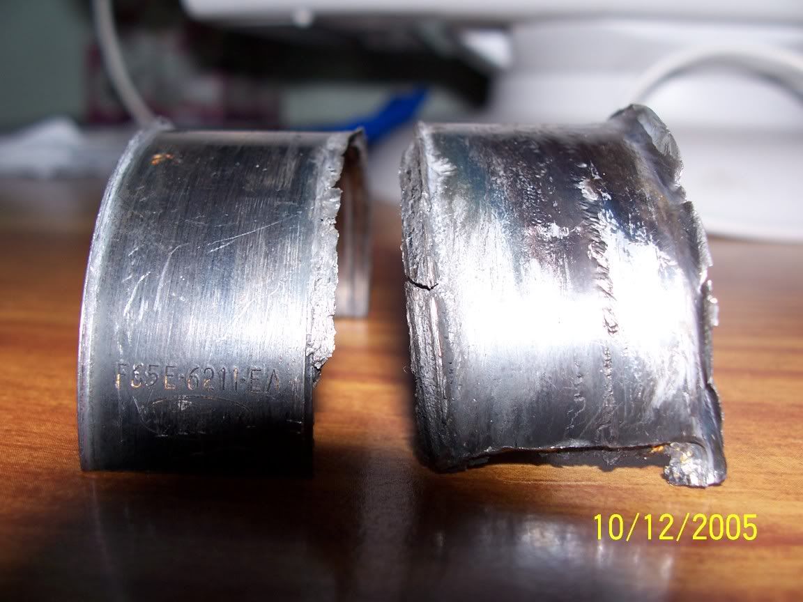

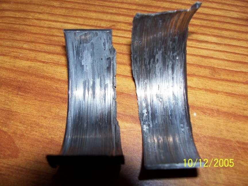

This is what happens when you do not change your oil
This is currently from an engine I have just pulled (As of 3:15 on 10-12-05) from an E-250 with the Triton 5.4L V-8 (Ford). As you can see - they suffered from a lack of oil causing the friction bearing to spin in it's hole. Pretty messy sight huh? All this could of been avoided if they just changed the oil. When I pulled the oil pan to be able to see what's going on - it was all Sludge (Very, very thick) and WAX.
So - please - even if is from that place down the street charging $10 - get your oil changed!!! You'll save abundle (This job [removing and installing the engine] is going to run around 20 hours...)
Hope this helps - and gives some of you an insite to your vehicle!!

How long did that go before since the last change? I'm overdue on mine. I'm at about 5500 miles on this oil I believe (and it's not synthetic or anything). I usually don't let it go that long but I've been really busy and been driving a lot. I'll probably get about 150 more on it before I take it in on Friday. I'd do it myself but it is so dirty and such a pain (and hot outsidehere in SoCal) that I'd rather just pay the $30 for someone else to do it and get it washed (included in the price) at the same time.
The service manual for the vehicle says change it at 5000 mi intervals but I usually do 3000 or 3500.

This had to be atleast 10,000 miles on very-very hard driving - but couldn't get a straight answer out of the owner.
Kinda freaky eh?

By the looks of those bearings the crankshaft can't be in much better condition. The top end would have suffered also. Once the oil thickens up and turns to sludge the oil galleries start plugging up starving the motor of lubrication.
Now I wonder if the owner will take better care of the Econoline van after this, or maybe they just had $3000-4000 they didn't have anything better to spend it on!
Was this motor still running when it came into the shop or was it seized up already?

Siezed already. Was a PITA to turn the crank to get to the nuts that holds the flywheel to the torque converter. Had to dissamble the whole bottom half...

I wonder if its possible to tell if the engine ran dry?
when oil has been used for a long time it gets thinner (lower viscosity), not thicker. The oil filter should remove any sludge.
Maybe the engine was running rich? O2 sensor shot? Valve fouled out throughing a lot of carbon into the oil?
Sadly many people think, when the oil light comes on it means you have to stop at the next gas station and buy another quart of oil
what it really means is, you better turn the engine off in a matter of seconds, because when the oil light comes on your engine is running bare metal against metal.

I think it ran quite hot. I did an engine failure analysis (Basically tear the engine down and see what went wrong) and found out that the lower intake gaskets where blown. Between not having any cooling and lack of an oil change - that's what ya get.
Yes - I am replacing the whole engine. Don't even bother messing with this one.
Ken - there was a TON of sludge/wax.
Yes - under normal conditions it does drop down to a lower viscoscity - but when it runs hot - it litteraly cooks the oil to wax. Have seen it very well on a neon that the head was completly wax-covered. (You could actucally chip away at it with a screwdriver)
For anyone wanting to know anything about oil (They go from what type to use when all the way down to the molecular level) visit http://www.bobistheoilguy.com Very, very good stuff in there!
I think this is the best you will get to tell if the engine ran dry. This was completly siezed on to the crankshaft. Had to chip it out with my air hammer!
