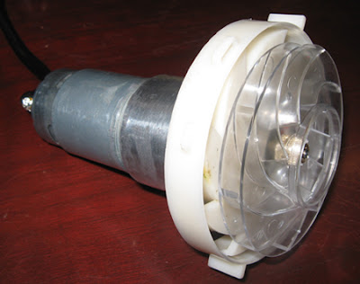

Here are two pictures of our turbine. It is a Dirt Devil hand held vacuum modified to fit a Fisher-Price motor with a 1:2 gear ratio. This assembly is attached to a 20" diameter dome.

Thats pretty interesting. I wouldn't have thought to use a hand held vacuum. Ours is slightly bigger and more powerful
http://www.chiefdelphi.com/media/photos/30155
