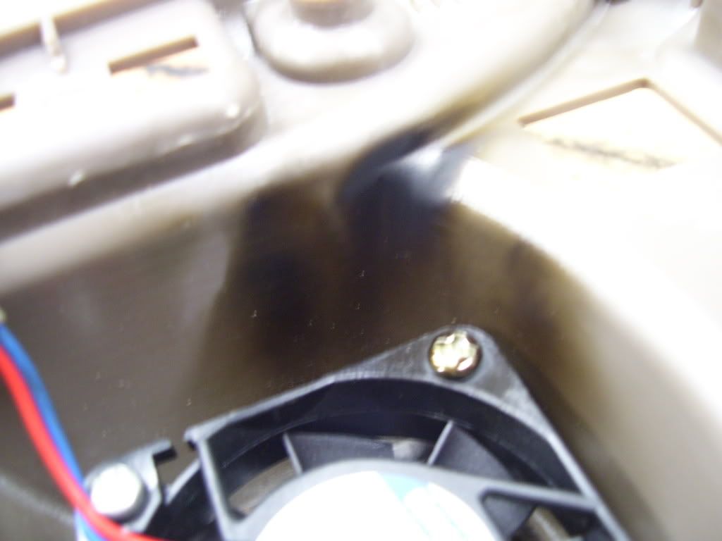

Our team (1606) had an interesting night tuesday when one of our jaguars released a plume of smoke while driving, all wiring was correct and the replacement jaguar is doing fine so we hope its just one that was faulty. upon further inspection after taking it apart it appears one of the power transistors had completly melted and began melting a second one and there were burn marks in the casing. has anyone else had this problem? pictures to follow...

Re: Jaguar Meltdown
here is a site for you to look at:http://tom-tech.com/first/wiki/image...ingStarted.pdf
there is a possibility the airway was blocked causing it to overheat.
also make sure you cap the PWM value using the calibration procedure listed in the document so it isn't at full.

Re: Jaguar Meltdown
airway was completly clear and our team leader says the pwm wasnt a problem. heres what it looked like...
after this the fan was checked and was still working fine

Re: Jaguar Meltdown
Just pointing out the obvious--traditionally, Victors have failed because teams have gotten metal shavings inside them; the team I was on as a student included. Are you absolutely mega-sure that this didn't happen? It is very easy to do, especially if the person with the drill doesn't fully realize the potential for disaster...
As for the team I'm with now, we haven't had the robot moving much at all, so we haven't put our Jags through their paces. If one of them self-destructs, I will definitely post back here.
You may wish to contact FIRST if you believe this failed under normal circumstances.

Re: Jaguar Meltdown
Jacob
absolutley we always cover all electronics when we do anythiong and we didnt find any foreign material in it when we opened it

Re: Jaguar Meltdown
This is the destruct problem with conductive debris. Remember that the full power supply is available on the FETs when the power is turned on. If a chip should contact the Source and Drain pins on one FET 12 volts will cause full current to flow limited only by the action of the breaker feeding the controlller.

Re: Jaguar Meltdown
I am currently holding in my hands a Jaguar that smoked about 90 minutes ago, and looks inside very similar to the above pictures. Upon disassembly, no obvious metal debris is present. Email already sent to LM for RMA.
EDIT: upon closer inspection of the above pictures, this one also appears to have smoked the chip on the lower right edge of the ring of FETs.

Re: Jaguar Meltdown
Dad,
It is common for debris to vaporize in this kind of failure. So it is next to impossible to determine whether there was something or not that a foreign body was the cause. Make sure to contact luminary and return it. They are doing forensics to determine failures at this point.

Re: Jaguar Meltdown
the picture that you had on there is a victor.... not a jaguar. here is a document i found online that may help you:
http://www.robotmarketplace.com/V883UsersManual.pdf
p.s. that is a bad picture of it

Re: Jaguar Meltdown
Originally Posted by Urban Hawk View Post
the picture that you had on there is a victor.... not a jaguar. Im going off to find another document to help you... hold on
This is a Victor. What was posted definitely is not.

Re: Jaguar Meltdown
That is actually the inside of a jag as stated by others, but more importantly you linked to the Victor 883 manual. While they are similar to the 884 they have differences and are not legal this year. I just wanted to point that out so no one sees that and uses 883's on their robot.
