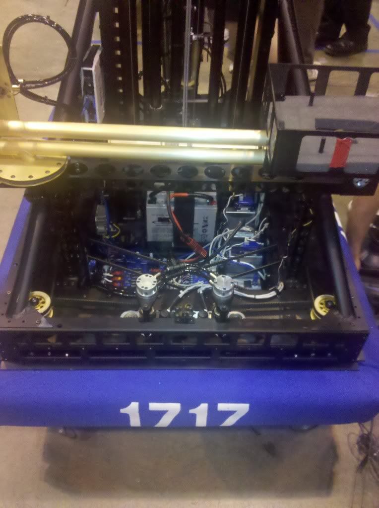

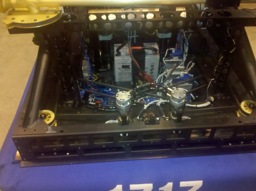

Everyone on 1717 was super nice about explaining their robot and actually showing us up close how it works. I was totally impressed!
Thanks for the photos, are those pnuematic motors attached to the steering belts or the drive belts.
I talked to 1717 for a bit about how their drive train works. Until someone from their team posts, I will do my best to fill you in.
The pneumatic parts you see are for their shifters. They put the shifter mechanism on the opposite side of where the Andy-Marks are placed. I don't know the full story behind this but I have a hunch that they did this because originally they were going to have each CIM have its own gearbox and each module independently steered.
From my conversations with one of their mentors, they choose not to go that route to conserve two banebot motors. So they have two CIMs for each gearbox
So the belts you see by the pneumatics are for drive and the ones the cross are for steering. The drive left wheels together and right wheel together. For steering, the front right wheel is connected to the back left wheel and vice versa. This means to rotate the robot, they have to come to a stop but they specifically designed their robot to minimize the need to rotate.
From speaking to the mentors/students, the gearboxes were designed/built in house.
As explained, you can see the left side and right side are both powered from 2 cims each on a 2 speed gearbox. The two cross belts control steering between left front/right rear and vice versa.
Mark, could you explain why they would need to stop to rotate? From watching their matches on Curie, I never saw them really stop moving.
I haven't been able to find many videos, but you can see them here: http://www.youtube.com/watch?v=n63CaX1W-pU (the red alliance robot with the black lift)
(Team 126 is looking into building a similar drivetrain for the off season)
