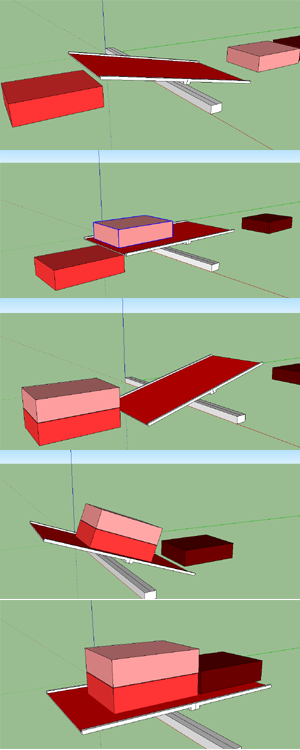

Originally Posted by davidthefat View Post
So in other words, go big or go home.
Taking from the new will.I.am song, you mean "You can go hard, or you can go home."
Anyway, here is a bit of thought that I'm sure many have thought about already: (please excuse the bad Sketchup drawing. I'm not finished with the final field.)
http://i48.photobucket.com/albums/f2...ingTheGame.png
Step 1: Carry Bot is on one side, with the other two on the other side.
Step 2: Carry Bot puts the Bridge on the top of their robot, allowing a robot to drive onto them.
Step 3: Carry Bot or the Third Bot moves the bridge down for the Two bots to get up.
Step 4: Two bots move to allow the Third Bot to get up.
Step 5: +40 Points.
Step 5: +40 Points.
Heh, this came up yesterday.
You'd need something like this, and it would be pretty hard. Look at other '07 bots
http://www.youtube.com/watch?v=zgHanZXFweg
Step 5: +40 Points.
We had the same idea.... seems like an interesting way to go. Need to get rule clarifictions about robot piggy backing.... I wonder about possible bumper zone violations for the upper robot.
If all robots can be designed to climb a 30 deg ramp... then they could just drive over the robot using 14in ramp extensions and then you don't require the use of a bridge to mount. This would have to be a very low profile specilized robot.
See the rule updates, all robots must be touching the ramp to be supported by the ramp. So now you just have to build a robot that can lift itself high enough to allow a robot to fit underneath. Maybe some team collaboration is needed.
