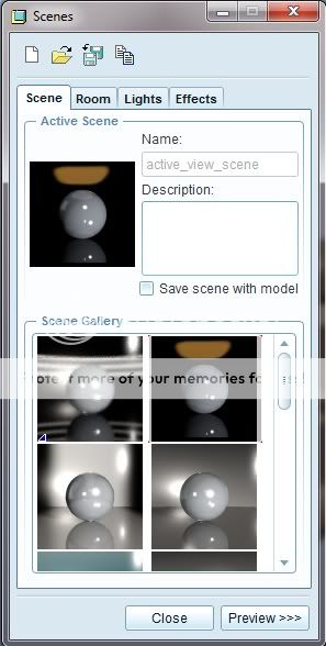

Within View > Model Setup > Scene there are four panels to become familiar with. The Scene panel itself includes what your current scene looks like, and many pre-loaded scenes that come with Creo. Often these scenes are sufficient, and you can simply double-click on one of them to set it to your current model.
The next panel, Room shows all of the specifics of the area your model is in. When clicked, it will display a likeness of the room the model is in in the model window so you can better orient the model for rendering. Here you can also play with what each surface in the room looks like, as well as the distance between the model and each surface. In general, I recommend snapping the floor to the model by clicking the button next to the floor measurement, shown in the picture below.
The next two panels, Lights and Effects, control the environment that the model is in. You can place spotlights, omni-directional lights, etc, and control their brightness and other properties. You can also play with effects such as depth of field and general reflection settings. There is a lot to do within these two panels, I recommend playing with them until you find something you like. If you have any specific questions about these, feel free to ask.

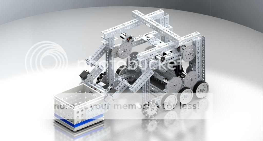

Finally, I would like to let you know that there is an example of one of our team's renderings from an old robot design in my picture above, and if you would like to use the scene we used in that rendering, we have decided to make it available; just let me know if you would like it. It comes with all of the lighting and room settings it needs, so it would be a quick load-up and you'd be able to get right to everything else. (I have edited this post to add the picture below; I didn't realize how small it would be next to my username.)

That's beautiful, Can haz full res render please?!
That is of course if you don't mind!
- Andrew

Yerp your renders really are beautiful!
We keep running into problems where PTC just closes and locks up due to insufficient RAM. About how many gigs do you think one needs to render the models using the settings you gave me? I have 4 gigs installed, but like I said, it locks up :/

I don't *think* ram is the issue. I have 8GB installed on the system that I use to render our models, but I don't use all of it while Creo is rendering. It only uses about 2GB of RAM; however, it does take quite a bit of processing power. I've got a quad-core CPU @ 2.83GHz, and each core runs from 75% - 100% while rendering. Even if you have a less powerful computer though, it shouldn't crash, it should just take longer to render. I have heard there are some issues with Creo and Windows 7, though I haven't had many. At what point in the render does it lock up?
Also, we'd be happy to share some of our renders at full resolution if you'd like. We have many on our Facebook page, here, and I would be happy to send some full-res versions around, just send me a message.
