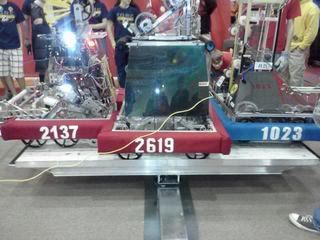

We recently took the biggest piston that we could find, put a ball cap on the end and riveted it to the chassis of our robot. Works like a charm.
Sometimes dumb ideas just work really well
We can now balance the bridge with only two wheels on the bridge (not legally).

GTW -- 2056 just showed (successfully) a pneumatic balancer on coop bridge, don't recall seeing that before
strapped onto the side of their collector

Check out team 118 at the Northeast Regionals in Hartford, CT.
The G10/Bridge grappler is gone. Now they have a complete bridge package. Pretty impressive.

Team 2054 has one, here is a video of a promo for Michigan State Competition
This is the Thread: http://www.chiefdelphi.com/forums/sh...highlight=2054
This is the video: http://www.youtube.com/watch?v=wjXBz...ature=youtu.be
We have a Big Arm that comes down outside the frame on a pnuematic cylinder, we have used it in double and triple balances. it worked quite well, we balanced every time we got a chance to at niles.

1023 added a simple one for Livonia as we had very little weight to work with, but did not use it during competition. We did successfully balance 3 several times on the practice field Saturday morning, but did not attempt it during a match. Thanks to 2137 and 2619 for testing it out with us!

180, SPAM, has a flipper they use to triple balance, lower the bridge, and traverse the barrier.
They didn't need to use it in Orlando or South Florida. They did, however, successfully use it on the SoFla practice field with 1592 and 3627 four or five times in a row before packing up to queue for elimination matches.
It can be seen at the 40 second mark of this video.

On the practice field before elims, we were able to balance 3 long base robots. 869 has their battery on a track, which allows them to shift weight. Buzz Team 175 has one heavy end, with a brake, to allow them to hang half their robot off the bridge.
We (team 126) have tossed around the idea of using our bridge manipulator as a "stinger", or designing something before going to STL.
Our 3 long base bots balancing in 30 seconds: http://youtu.be/_-BasVh4beo
