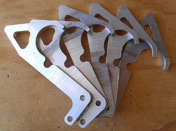

Hey all,
I just wanted to let those who were curious about our hook design see why they weren't included on the image. It may be a little late, but here they are.
Many many kudos to James Tonthat and 1477 for helping me resolve this design and even manufacturing them for us. We'd be in bad shape without their help.
Cheers and good luck,

Re: Bronc Botz Team 3481 '13 - Twister
Also thanks to 1429 for providing the shop and the material.
