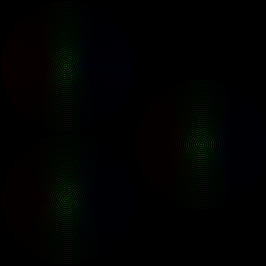

Originally Posted by apalrd View Post
There's still more optimization we can do. I like the interp curve function because I can plugin a set of points and map the curve as I want, however nonlinear or strange it is, without finding a mathematical way to represent it, and it's not that inefficient for relatively small tables.
I have made a graphical representation of 3 different setups that try to illustrated the distribution. The one on the right is halo drive with just x and no y, and the top left is the culver theta * r where r is just magnitude with no scale. The bottom left is the blend of 0.875 to (1/(pi/2)=.64ish).
The green tries to highlight the smaller numbers and how they are spread out. The spread of numbers between the 1.0 magnitude and the halo are virtually identical for the precision workflow (i.e. when using the max y stick up)... This means the actual benefit of precision (using 1.0) is a mechanical solution and could be accomplished using the halo drive. It does however have brighter red and blue intensity on the sides this is because when you get there your range will exceed past 1.0 to 1.57 (half a pi). The bottom one will keep the range 0-1 intact for halo while spreading out the centered area for Culver. This makes it both mechanical and functional benefit of precision. This suggestion makes the Y component a bit more interesting in that when Y is centered... it is identical distribution as the halo graph (therefore a perfect fit for anyone's driving system), and then when Y is used for Culver steering... the x distribution is greater for precise turning and then curves down quick to meet up with 1.0 at the end. I hope this makes sense... I can see a work flow solution to use halo drive for quick turns and culver drive for precise turns without need of a button. Quick turns in this context are in terms of what the x axis submits to another function... this means it is possible to use this for some other kind of control (e.g. arm) when it is broken down to just this functionality.
I'll save the actual drive implementation for a separate post.

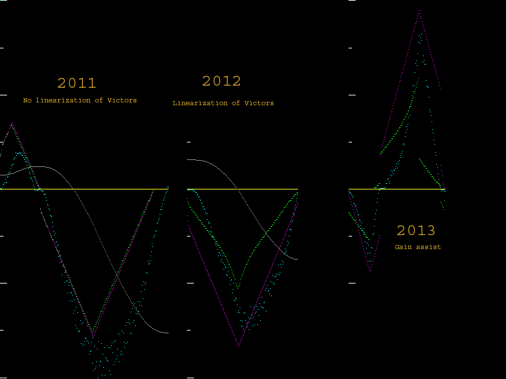

-We do like velocity controls as well, but we haven't implemented them since 2011. I think that would be a logical improvement to this system.
-That said, a simple PI controller to speed does not have a fast enough response time for drivetrain usage. We did this in 2011 and turned the gains WAY up for fast response, and oscillations weren't very good, but it worked.
-A better solution is one of the better speed control algorithms designed for shooter flywheel speed control (2012 was especially big on this, 2013 less). We ran a PI-FF algorithm with a feed forward equation (now we would just use a table), which is an improvement
Yup... I've been through the ringer of that as well as shown below... in 2011 we didn't know the value of linearization of the victors... which I guess is no longer an issue with the 888's. In 2012 we used the polynomial equation from Simbotics which worked out very well. In 2013 we applied the gain assist.... without gain assist the drive takes around 210 - 300 ms of latency. Using a closed loop solution brings that down to around 60ms. Using gain assist makes it virtually 0. This test shown here is a setpoint test using the drive like a turret... where each pixel column represents a 10ms iteration. The Magenta is the velocity line the green is the voltage, then Cyan is the encoder reading, and the yellow is PID error correct (which is not used in these tests).
