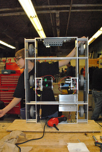

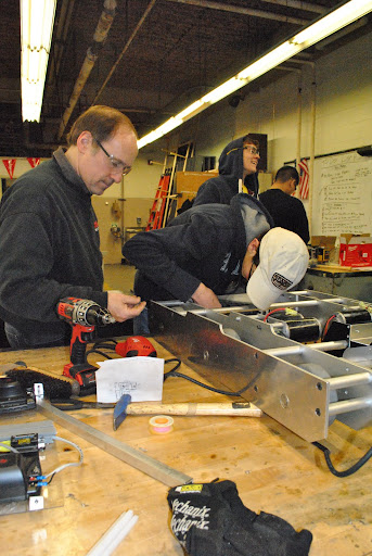

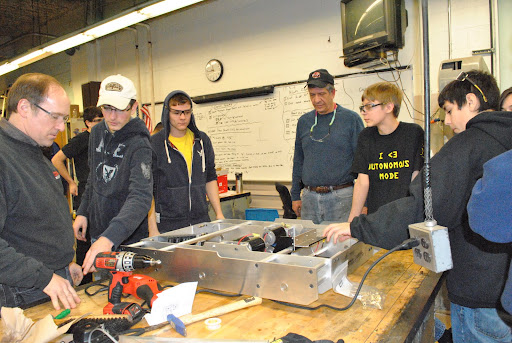

Hello I'm Grayson! On this project I helped out a little bit with a lot of different parts, including machining, CADing, and assembly. My main contribution was putting together most of the left (I think) drive pod and doing the chains (which took me longer than I care to admit )
