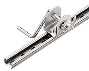

I have looked for a thread or posts on this on CD, but I haven't found any yet, and if someone could post a link that'd be great, but how is your team releasing your shooter? I've heard some different ideas, but what is your teams plan?

Re: Release Mechanism
Thanks!
The above mentioned options are all good, but they make it a bit tricky to have multiple launch settings.
We're looking at using something like a volleyball crank with a pneumatic piston to release the lock. This means you can draw it back as many or as few clicks as you like.
Hope that helps!
Hope that helps!
quick question on the volleyball crank. When you press the release, does it have to spin the handle (which would be mounted to a motor) to be released? because if it has to spin backward, it wouldn't quite get all the power since you would be spinning the motor simultaneously.
