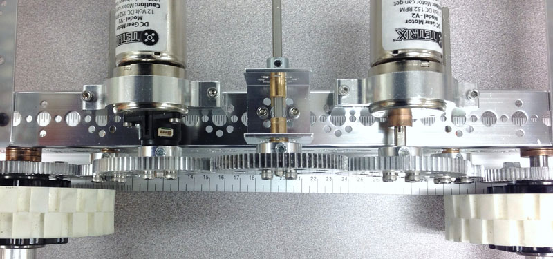

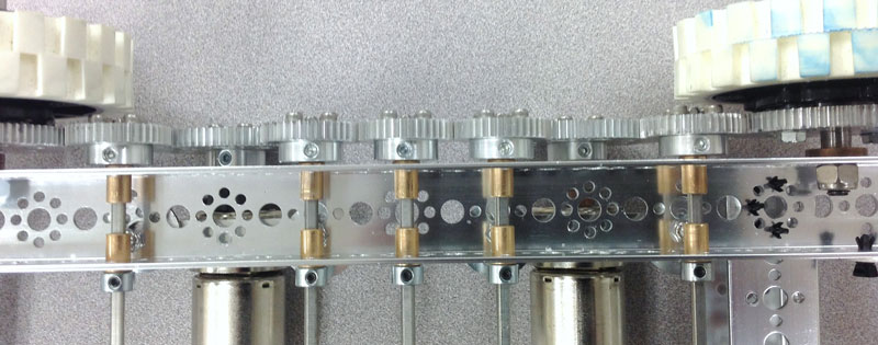

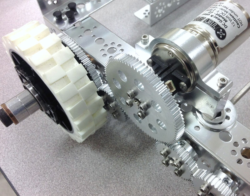

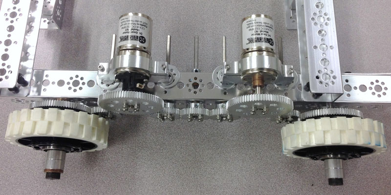

I think we have a prototype for one side of our new drive system.
The washers under the motor mounts will be replaced with 3/16"x1/2" spacers, the shoulder bolts will get shortened 3/4" (eliminating the Al spacers currently outside the wheel), and the lengths of the bolts securing the motor mounts to the channel will get sized properly. We'll reinforce the channel near the wheel mount area.
We put press-in bearings in the hubs of the AM Hi-Grips, which ride on the shoulder bolts. Its very smooth. Overall, everything spins pretty well.
These two motors will get connected to one channel of the motor controller and we'll duplicate everything to the other side onto the other channel.
Are we headed in the right direction?

Re: [FTC]: Can I add non-slip material to 4" Tetrix Wheels?
Definitely looks like it to me!
If you can figure out a gear or spacing to replace those three middle gears with a single gear, that would probably be more efficient.
You guys are definitely headed down the right track!

Looks very good! A few notes to think about:
1. Fine tune the spacing between the two wheels to find a good balance between stability (from a longer wheel base) and turning ability (from a shorter wheel base)
2. It's been a while since I've played with TETRIX gears but I'm fairly certain you don't need all four screws to mount the gears to the shaft collars. Two will probably suffice but four doesn't hurt
3. Find a spacing such that there's the least number of axles as possible (for simplicity and maintenance sake)
Keep up the good work!

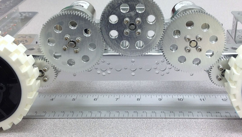

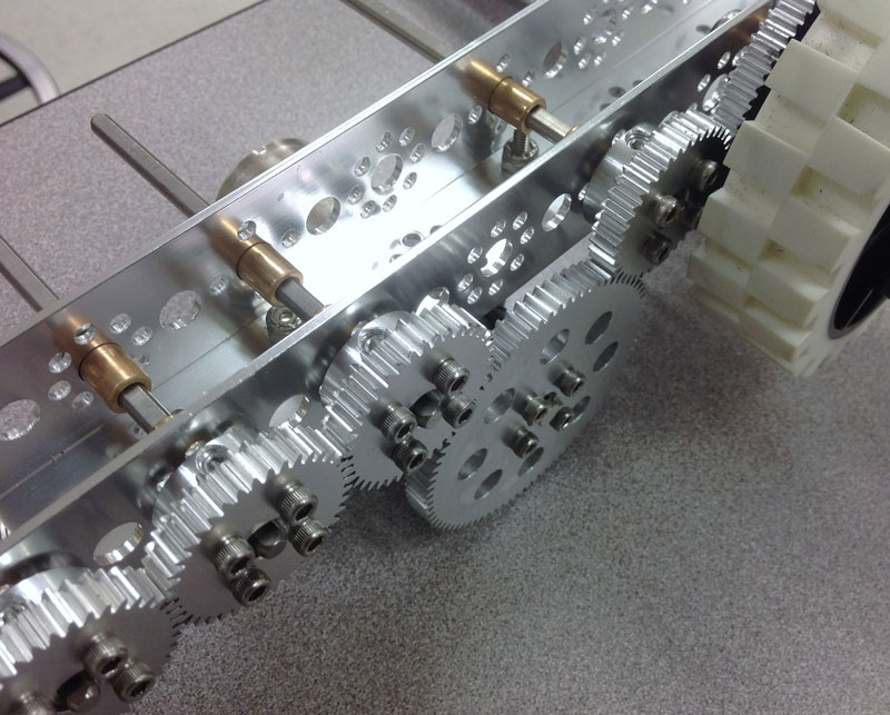

I was able to borrow some 80T gears yesterday!
1. Replaced the 3 40T center gears and their axles with one 80T. This also allowed us to eliminate the spacers under the motor mounts and gave us some adjustment range between the two motor gears and the driven gears. This drive train runs smoother and feels "right".
2. Wheel base increased from our original 10" to 11.25". We tried eliminating the remaining two small gears (the next increment smaller) but couldn't get the gears to mesh correctly. I'm okay with the increase.
3. I think the larger gears might run a little truer when all four bolts are used on their hubs. I don't think it matters with the 40T gear.

Over the years, one of the things I have often seen on FTC and FLL robots is the wrong spacing on gears. Often they are spread too far apart which allows them to skip but at other times I have seen them jammed together which causes high frictional loss and heavy battery loading. If it looks better and sounds better, I think you have a better design. I am a firm proponent for "the robot is talking to you" philosophy. If it is making funny noises, it is telling you something is wrong.
