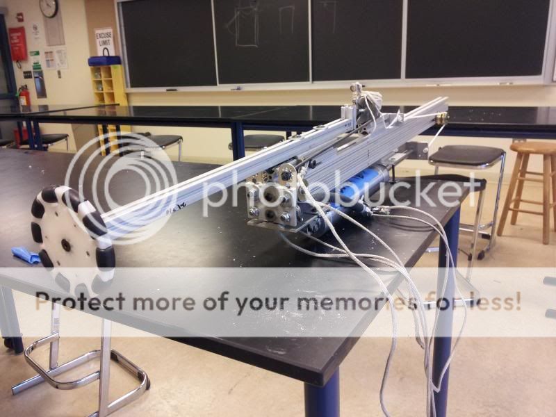

Surgical tubing puncher with pneumatic retraction:
http://www.chiefdelphi.com/forums/sh...highlight=rail
It is all about hitting a good peak ram velocity while it remains in contact with the ball. Having pneumatics pre-pressurized and surgical tubing prestretched with ram in retracted position is important. Rapid acceleration is what is needed, so a low mass ram with high initial force is best,
-Dick Ledford
FTC 3507 RoboTheosis
FRC 3135 Robotic Colonels
My advice to you and the rest of your team is never have your face anywhere near this beast when pulled back. I still get flashbacks to 2006 when we tested a similar method for launching foam basketballs.
I don't mean to call you out, but I don't think 2006 had basketballs. I believe the balls were foam though.
It it is a little scary standing next to it while it is loaded. Luckily we don't have to do that during the competition.
