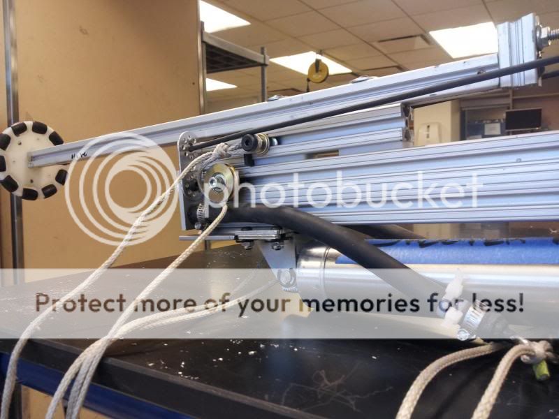

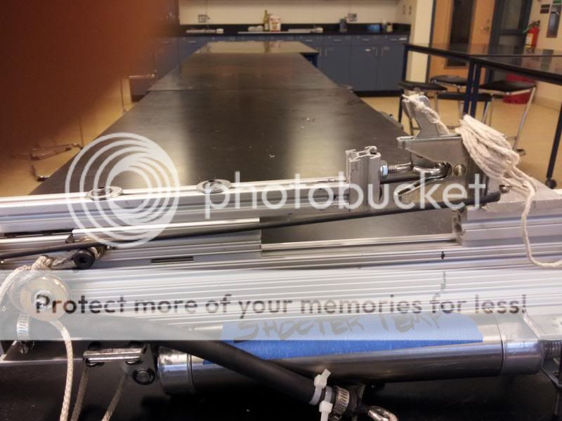

RAIL GUN: linear slide ram shooter
Team 3135 has nearly completed our prototype linear ram shooter --- just a trigger cylinder needed, and removing excess length wherever possible. It is structured with slotted framing and uses a unique and largely unknown 80/20 nylon bearing slide element pictured below.
The backbone is a 2" x 1" 80/20 segment, that will end up 24-28" long once we remove the excess length. It is a high force, hybrid pneumatic & surgical tubing system that has two slider blocks on the top. To one block is mounted the ram, and to the other is mounted the retractor/latch/trigger assembly.
Needed force required at least dual surgical tubing elements for ram power, and we needed minimum torque applied onto the slider, so we went with a bilaterally powered scheme of surgical tubing and high tech cord wrapped on pulleys to limit length.
Once we realized that it was primarily just hitting peak ram/ball speed during stroke engagement (not launch force or ram momentum) that gave best shots, we minimized the ram weight (dropping down to 20x20mm frame) and shortened the stroke (10" now and headed for 8" we expect). The ball starts right up against the ram tip too.
Surgical tubing is 1/8" ID by 5/8" OD with ~8* of stretch zone and is prestretched by ~6" at the full stroke extended point, with the retracted & ready to shoot position taking the surgical tubing near to 22" stretched, close to the 3X max. recommended extension. Tubing ends are 1/4" H/W, and tricky to keep from pulling out at near 3X stretch levels.
We were planning to do a variable power gearmotor winder scheme, but opted for initially trying a single power pneumatic ram retractor instead. After shots, the gate latch trigger's slider block reengages the ram end by tension from some thin surgical tubing, that also keeps the cylinder's retractor cord taught during reload cycle.
The 4" omniwheel ram tip seems to give a uniformly good enough force distribution on the face of the ball without adding much weight.
We still need to improve the path of retractor cords to be closer to parallel to the latch slide path.

I'd be curious to see the robot that this is going on top of... it looks a bit large for any standard chassis.
Its going onto the long version of the AM14U.
Currently under 30" when excess backbone frame is removed (camera exaggerates lengh), and removal of other excess component length will further shorten down to as low as 24" OAL.
If stroke is only 8-10" and ball sits high on robot with much of its size protruding beyond 60" elevation we have about 55+" diagonal lengh inside frame to work with for setting our shot angle.
Too few catapult shooting teams are realizing how easily their shots can be defended and blocked by a basic speedy & maneuverable opposinng bot just sitting right in their face. We plan for our shots to clear any possible defending scheme.

Originally Posted by Patrick Flynn View Post
One thing I'm going to forewarn here, from experience those 80-20 sliders will wear, and once they do nothing will want to slide at all. Also if that 80-20 ends to the slightest bit bent sliding will be difficult if not impossible Having the ability to quickly replace those sliders would be a design consideration you may want to look at.
Other than that design looks awesome, can't wait to see more of it
Yeah, thanks for the heads up, we already have spares made to cover that issue. This was one reason we are being careful to keep all net forces on the sliders as near to axial as possible, with minimum torque being carried by nylon contact area. Still some improvements needed in that regard.
