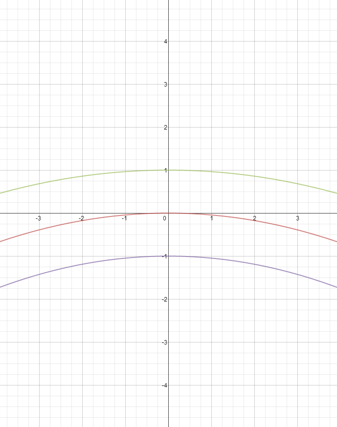

Math Quiz: Parabola Path
The center of a circle of radius=1 traverses the parabolic trajectory.. y = -0.0433*x2.. from x=-5 to x=+5 in the XY plane, and as it does so it "sweeps out" a path with upper and lower boundaries.
Find the equations for the upper and lower boundary curves.

Re: Math Quiz: Parabola Path
Hint: the answer is not
Code:
y = -0.0433*x2 + 1
and
y = -0.0433*x2 - 1
I get:
Top curve: y = -0351x^2 + 1
Bottom curve: y = -.0433x^2 - 1
Originally Posted by Qbot2640 View Post
I get:
Not. See my previous post.
I assume there's supposed to be a decimal point before the "0".
Nice try, but no cigar.
My mistake...I had all three equations together, and grabbed your original as the "bottom". The top I got (as you corrected my missing decimal) is 0.0351x^2 + 1
The bottom I got was 0.0474x^2 -1
I calculated two normal lines and found points that were 1 unit away from points on your given original. Then calculated the quadratics from the two sets of three points (although the y intercepts being known, one really only needs two points).
The top equation y = -0.0351x^2 + 1 is still not right (even with the required "-" sign added back in )
The bottom equation y = -0.0474x^2 - 1 (with the "-" sign added) is a very good approximation in the given range, but as you can see in the attached graph, it diverges outside that range.
You've got the right general idea.
Then calculated the quadratics...
Hint#2: the top and bottom boundary curves are not true quadratics.
Can I give the answers in parametric form?
Spoiler for parametric plot equations:
xlower(t) = t - 0.0866 t / √(1 + (0.0866 t)2)
ylower(t) = -0.0433 t2 - 1 / √(1 + (0.0866 t)2)
xupper(t) = t + 0.0866 t / √(1 + (0.0866 t)2)
yupper(t) = -0.0433 t2 + 1 / √(1 + (0.0866 t)2)
