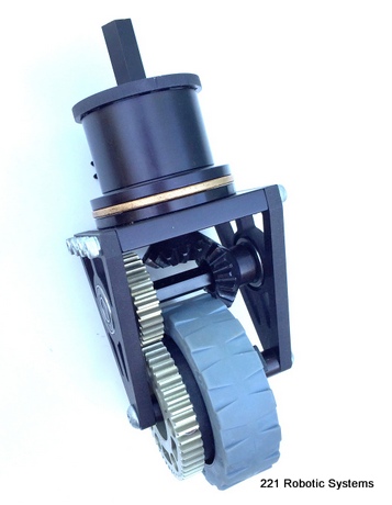

Some of the pictures on the product webpage don't seem to match the main product picture or the PDF. ( http://www.team221.com/upload/king_crab_detail.jpg )They apparently use the older revolution swerve design at least for this pic. (and I doubt that the new design would even work on this platform because it's so much shorter, no height for a CIM)
Also the PDF shows the input as 3/8 keyed shaft while the product picture ( http://www.team221.com/upload/revolution_pro.JPG) has a hex input.
Uploading a CAD model would explain these discrepancies I'm sure.

Good observations. The image on the main page is of the original prototype. It had a 1/2" hex input on the vertical drive shaft. The production version sticks with the 3/8" keyed shaft.
The images of the complete robot are really just for reference. We just finished building it...it used a classic module. The new modules aren't quite ready.
I will post some step files soon.

Originally Posted by Bryce2471 View Post
My observation was more based on the large amount of optimizations that appear in my posted designs. Not on completely brand new ideas that have never been seen before.
You pointed out that your designs were disturbingly similar, implying that the Revolution swerve module had somehow copied yours.
1. It uses a small diameter solid treaded wheel.
Excluding 2009, show me a swerve drive that does not use a wheel with a tread. Teams have been using small wheels since 2008 (http://www.chiefdelphi.com/forums/sh...ad.php?t=64824)
Here's a team using a 3" wheel: http://www.chiefdelphi.com/media/photos/38289
2. The wheel is off set slightly to one side so it can be nested by the miter gear.
See 148 in 2008. The wheel is off center in that design.
3. It utilizes straight cut gears instead of a chain to transfer power to the wheel.
See 148 again.
Or this one: http://www.chiefdelphi.com/media/photos/37005
4. It uses a dead axle to keep side plates light weight.
See this design: http://www.chiefdelphi.com/media/photos/34443
Or any 118 robot since 2005.
5. The wheel axle is a hallow stand off to increase the strength of the module and make replacing the wheel easy.
See the old revolution swerve design.
Also, this drawing shows that their wheel axle isn't hollow. (http://www.team221.com/upload/445-Revolution_Pro.pdf)
1. It uses a single extrusion upper frame.
221 Robotic Systems has used this frame before you have.
2. It's CIM motor is behind the steering motor, in an in-line configuration.
Where else would you put the steering motor?
3. CIM chain runs around the steering shafts to get to the main double shaft.
118 has done this in 2007.
Excluding this and Aren Hill's in wheel CIM swerve, most swerve designs are very similar, or fall into a few categories.

Thank you so much for this, I took a cross section and noticed there is a 1/2"id bearing right above the vertical bevel gear that doesn't seem to be doing anything. If it were 3/8 it would be guiding the shaft which would make sense, am I missing something? I also noticed there are no thrust bearings anywere, only thrust bushings, I guess you have found this to be acceptable?
Also, in the prototype with the hex shaft sticking out the top how did you manage to assemble that without using larger diameter hex bearings and thus a larger overall diameter?
Looks like a modeling typo. It's the same 3/8" ID bearing shown at the top of the stack. Thrust bushings are the answer. We used them on the classic Revolution and they performed great. Actually a lot of swerve guys think you can send the thrust loads directly into the ID of the bearing....I like the additional overhead that the bushing provides.
The shaft was 1/2" hex to 1/2" round to 3/8" hex. It used a 1/2" ID x 7/8" OD bearing....the same one incorrectly shown in the model actually. Vexpro sells them. We changed back to the keyed shaft as the original design was cost prohibitive.
I've updated the model with the correct bearing.
