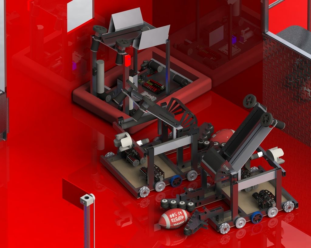

It took us a while, but we got it done!
The team was made up of Anthony Cardinali, Roger Moore, and myself. We were one of the two teams focusing on making an entire alliance to play in Elims. We wanted a team that would be able to take on Einstein-caliber robots, and based our strategy around that goal.
Strategy
We made two types of robots; Full-Court (FC) and Cleaner. One FC would be able to wedge itself into a corner and do full court shots all day, while the two Cleaners would pick up and score any fallen footballs
Here is the strategy we came up with:
1. Auton
-The two Cleaners would start next to the middle zone and take two shots, then move to the auton zone. The FC would move to the auton zone and wedge itself next to the HP station and take a shot thereafter.
2. Teleop
-The two Cleaners move immediately to the opposing auton zone after getting footballs at an HP station if possible. They then focus on stopping opponents from getting to their HP stations while picking up and shooting any missed FC shots. The FC takes full-court shots until the end of the match.
3. Endgame
-The FC continues shooting. The one Cleaner (or both, if necessary) go back to their zone to raise the flag. If there is heavy defense, they focus on stopping the single opponent for the last 20 seconds.
Features of each robot
The FC has mecanum wheels to maneuver into the corner easily. It is long enough to wedge itself into the corner but still allow for HP loading. The shooter is powered by 2 CIMs spinning urethane wheels fast enough for a double-length field full-court shot. The shooter was supposed to be farther back to prevent defense, but we ran out of time to implement that properly. Presumably something that folds out could also work well for that task.
Footballs are actuated into the shooter wheels with two pneumatic cylinders. We did not have time to add an actuated "hood" over the shooter to stabilize the football after loading.
The whole robot is around 65lbs with electronics, so plenty of space for more power or features.
Features to add would include the shooter hood to clamp down on footballs, an improved HP loader, a taller/higher shooter (and an elevator with it), and a shorter time-to-shot (to be faster than the HP can load, ideally).
The Cleaners are equipped with a 10WD made for crossing the bump. AM performance wheels and blue nitrile tread in the middle act as a dropped center, colson wheels provide some traction on the outside, and omni wheels on the corners allow for easy turning. The center wheels can be swapped for a colson if the dropped center isn't working out. They also have intakes that can pick up a fooball in any orientation. The intake tilts up to aid a polycord elevator (they act as two walls of it) to put the footballs into a shooter. The shooter is the same as the FC's, and is also missing the hood to stabilize the ball. It is tilted as such an angle that we can make shots as close as 4-5 feet away from the goal.
There are two WCP PTO gearboxes, but we were not able to properly implement the PTO. Instead, a 775pro going through a Versaplanetary powers the spinner, which is made to fit into the mating gripper on the flag pulley. We would most likely forgo using it during an eliminations match, as it is worth more points to go for full-court shots or just play defense while the FC scores; it's too hard to raise the flag uninterrupted for both sides.
The Cleaners weigh 70lbs without electronics (perhaps 85ish with?), so there is space for more stuff.
Features to add would include a way to load from the HP station, a 4-sided elevator to replace the a double-duty intake, the clamping hood for the shooter, and a better way to raise the flag. Also adding the bottom half of the polycord pulleys; the top half is there (hidden behind the curved hood), we just forgot to add a shaft with pulleys on it on the bottom. We also appear to have forgotten to add the motor to the intake. Again, all the sprockets and even a mounting hole for the gearbox is there, but we forgot to add it.
CAD is available here: https://workbench.grabcad.com/workbe...K7tC5bgRH65eR2
Pictured are two Cleaners and the FC.
Click on the photo and click on the magnifying glass to view a higher-res photo. The intakes on the Cleaners are asymmetrical due to Solidworks mirroring problems.
