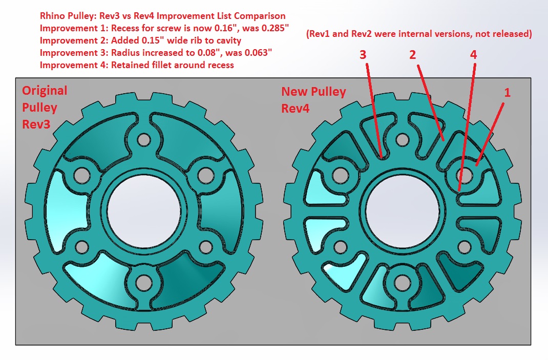

Corrective Action:
There is enough evidence here to justify that we need to improve this mold. Once we get a new part designed, I'll post a pic of it on this thread with the additions highlighted. Since our molder is here in Kokomo and works with us very closely, I am confident that we can make a mold improvement and have parts available within 8-10 days. Thank heavens this part wasn't made overseas.
* - While you may need cracked pulleys sent to you very soon, you may also wish to wait until we get this mold changed and have new, stronger pulleys. Please stay tuned for timing regarding when we can do this.
I am warning our ops and customer service folks that we may be sending out many replacement pulleys soon.
It will be an interesting week. Please stay patient with us as we solve this issue.

Richard, this is brilliant! Thank you for posting the idea. We may try something similar here in our tests. You're an ME in disguise!
Regarding the mold changes, we are implementing 4 changes to the pulley.
Due to the speed of things happening, if folks want to post input here on what else to do to this Rev4, it may or may not get implemented.
Andy B.

Andy the revision looks pretty good. Are there going to be longer bolts included in the upgrade or do you feel the current bolts will be long enough even with the bolt recess change?
Good question, Cliff.
We also discussed this issue. The distance of thread engagement was 0.485 with the current version. With the new version (Rev4), the engagement will be lessened by 0.125, resulting in 0.36. Since there is a taper on the end of the screw, the last 0.15" (approximately) can't be relied on with regard to screw thread engagement. So, we now have about 0.21" of engagement. Since it's a 10-24 screw (with 24 threads per inch), that means we now have 5 threads of engagement at each screw. With 6 screws all having this same engagement, we believe that this will be enough. However, we will make a test and report back if this is good or not.
Andy B.

Do the failures seem to be coming from the weakest area as shown by the arrow? It seems that way, but we haven't busted any because we haven't driven any... Busy work on more important things.
Yes, you are correct, Brad. That is where the failure is happening.

If that's the case I think it would be better to change the screw so it has a smaller diameter and can be tightened without a socket such as a hex head, but I doubt you can source that in self threading style.
I just seems that's the area that needs to be modified to make the most strength in addition to the ribs.
Any thoughts on a material change such as Nylon?

It seems like the fact that there's an edge rather than a chamfer/fillet where the well for the screwhead begins (radially out from the center) might be a point of failure. All of the fractures pictured are at the depth of the well, so I think having an edge there to bend around is contributing somewhat. Just a guess though.
