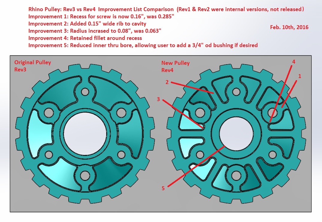

Another update:
Here is a picture showing our pulley improvements for Rev4. The guys working on mold said that they were working on adding the ribs yesterday, so this change is progressing well. We should see new parts in a couple of days.
Also, we are keeping a log and summary of what all is happening on this web page.
At this time, we have contacted (emailed) all of the customers who have contacted us regarding this issue. So, if your team has not heard from us about this and you think that you should have, please send an email to sales@andymark.com.
Sincerely,
Andy

Re: Rhino track failier?
Originally Posted by Andy Baker View Post
Another update:
Sincerely,
Andy
Thanks Andy. I think that addresses the problem our modified 3D model fixed. It's nice to see you guys paying such close attention to this issue.

Another update for today:
We've got good news and bad news.
The GOOD NEWS is that the pulley mold modification is done and we have some first run pulleys. They look good so far, and we are testing them now.
The BAD NEWS is that there was much sinking around the inner bore when we reduced that bore to 0.754". So, we won't have Improvement #5 as I mentioned earlier today. We will have Improvements #1-4.
Our mold tool has is a two cavity mold. The tool makers changed the inner bore to 0.754" on one of them, but they left the second one at the original size. They are changing the one back today and tomorrow so that they are both at the original bore size. This eliminates the change which helped users add in a bushing if they wished to do so. With these new Improvements (1-4), I don't think that this bushing addition is needed. It would have been nice to have it, but since it caused sinking trouble with the material, we quickly gave up on that feature.
Originally Posted by OccamzRazor View Post
This won't add anything to the solution of the problem with the plastic pulleys but I figured I would ask to see if it is an option. What would the cost look like if these were machined from aluminum instead of plastic injection molded and is it cost prohibitive? Some teams including mine would probably pay extra for metal rhino pulleys. The performance wheels run more than the plaction wheel products so is that a similar parallel?
Obviously it is a little late in the season for a new run of products but is that option on the table or is it just too expensive in this case?
No, we are not going to offer aluminum versions of this pulley.
We strongly believe that our Rev4 pulley is very strong and will handle the application well. We have ran our first tests today using these pulleys and beat up our test mule like crazy. We will post a video shortly.
We are now running production of the Rev4 pulley and will have them available to ship out early next week (2/15-2/17).

We just received a box of Rev4 pulleys. The parts are still slightly hot, as they literally just came off of the mold machine.
If you have sent us an email claiming cracked or fractured pulleys, then we are sending Rev4 replacements out today via Ground delivery. If you have sent us an email wanting replacements but don't have cracked Rev3 pulleys, then we are shipping those out on Monday.
Andy B.

This is awesome! I love that FRC Suppliers solve problems like FRC Teams. Quick iteration and quick implementation!
I may have missed it from earlier in the thread, but have you emailed all the teams that ordered Rhino tracks with Rev 3 pulleys? I just ask because I'm sure there will be teams that ordered the Rhino system without realizing a cracked pulley until it's too late (aka at competition). These are the types of teams that wouldn't be checking CD or Lunch with Andy (which I watch religiously!)
Thanks for all your work on this and keeping all of FRC "rolling"!
