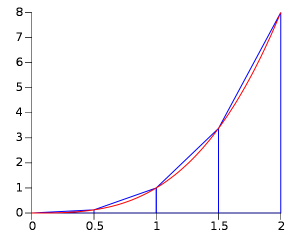

So... ...I lay in bed last night thinking about this unexplained shift. Morning found no solution but an inkling of an idea came to mind as I cut up my apples for the day (if 1 apple keeps the doctor away, what does 4 do?). I thought about the Trapezoid Rule and Integration. It is well understood that for some types of functions (specifically functions with positive second derivatives in the range of interest) the Trapezoid Rule over estimates the area under the curve. Here is a graph that helps show why (image source):
The trapezoids have a little area they count that is not quite under the curve in these cases and that causes a systematic over estimate of the area under the curve.
I was doing integration. Was that my problem? I thought and thought and decided that it wasn't the source of this bias. BUT... Then it came to me.

So. I think I have found the culprit. Based on the graph below, I think you will agree that the shape of the Max OPR function has a bias to be concave up in the region of interest.
I think for the same reason that the Trapezoidal Rule over estimates the area under there curve, the Excel's PERCENTILE.INC will over estimate Max OPR when it has to interpolate. Also, Trapezoidal Rule case, the curve is the greater the curvature of the function you are integrating, the greater the error. And in my case, when I included the right most portion of the curve (Method #2) which tends to have the Poofs, Robonauts, etc. and therefore have more curvature, my error went up. Doesn't prove anything but it IS suggestive.
