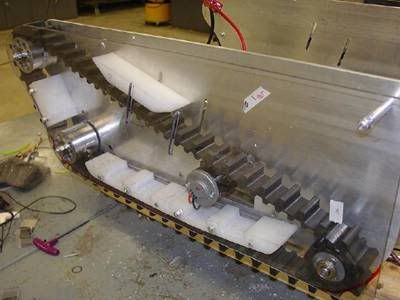

This is a picture of the best close up of our treads from 2004 and then Cyber Blue 234's finished robot. We found these treads at http://www.thistle.uk.com. They worked amazingly well for us. We could shoot up the 6 inch step without any problems.

Dave that my man is how you do treads right there. Thanks for posting the great pictures. One of my favorite all time bots right there. Cyber blue rocks a model bot and model team right there. Definitely study that example right there for tank treads. The v belt system is awesome definitely use it, the belts will tend to track off if you don't. We learned that from experience.
Well done,
