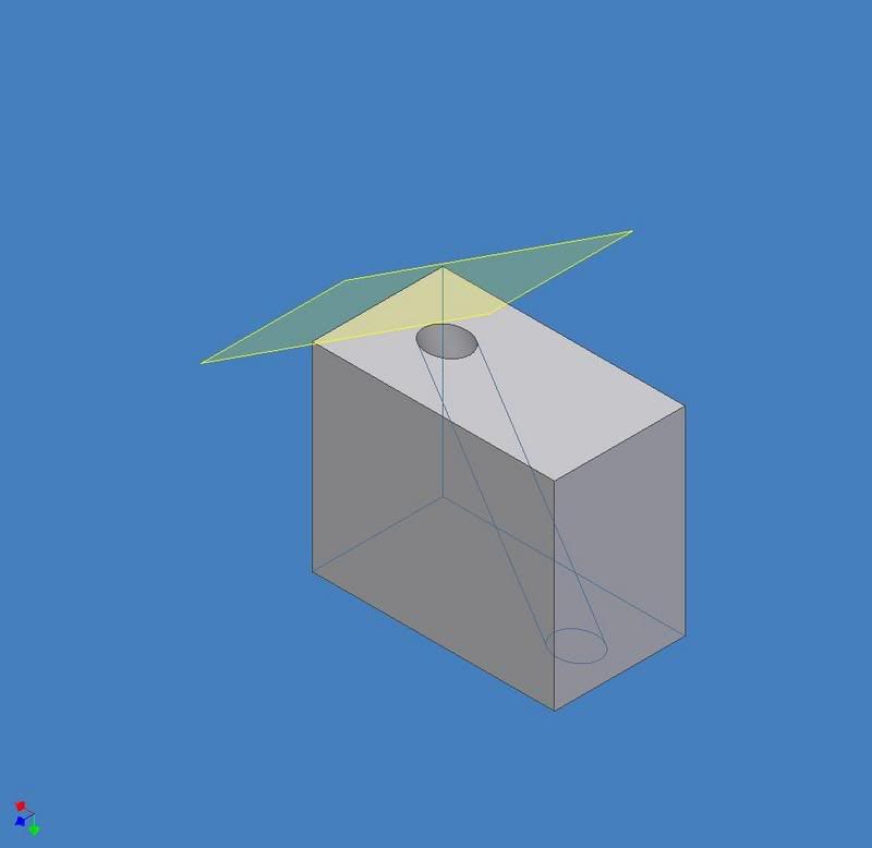

Angled holes?
Hello everyone. I'm trying to make a hole at a 45 degree angle from a surface, but i can't seem to figure out who to do it. the only way i was able to do it was to make a surface at the angle i wanted, then i drilled the hole through it, but then i couldn't delete the surface and keep the hole. Anyone know how?

You should be able to create a new work plane that is offset 45* from the surface the hole enters into (assuming it's flat) and then create a new sketch on that plane for the hole.

I don't have Inventor in front of me now, but what about creating a work plane at an angle to the existing surface? Then sketch the outline of the hole in the workplane and create a feature, setting the depth to whatever you need (through to reverse side). To be honest, I don't remember if Inventor will let you create a solid material removal feature (i.e. hole or cut) from a workplane in space, but it's worth a shot.
Also, since you may want to actually build the thing later, be aware that it is tricky to drill an angled hole. You'd either need a drill guide (some hard material which already has the desired angled hole), or a very stiff machine, like a milling machine and a short, inflexible bit or end mill. Even if you tilt the table of a drill press, the bit will usually walk off and make a mess.

Creating the angled workplane would be the correct choice, but actually doing it is tricky. I'm using Inventor 9 and don't know if there's another solution for other versions. Anyway, an angled workplane must be created based on two references: an axis that it will rotate upon and a surface that the inputted angle will be based on.
Your axis is already there if your hole is on the edge of an object, otherwise, you'll have to create your own axis. You can create a line in a sketch, a work axis by two points, or a work axis by a point and a surface (it will be perpendicular to the surface and pass through the point). The surface should be easy to find.
If your hole is on the corner of an object, I would have to call you crazy, but it can be done. Ask if you need more help to do that.

if you want to delete the surface, don't "delete" it, but right click the feature on the explorer thingy window, and supress the feature. the feature won't show up, but you will still keep the hole

Don't suppress it, hide it instead (visibility off). If the program is working correctly, suppressing the feature will suppress all dependent features (e.g. the hole you want to keep). Hiding it just makes it invisible.

Creating an angled workplane in Inventor, version 10 at least, is actually very easy.
In the image I've posted below, I created an extruded block. To create the angled workplane, I first selected a face, the 'top' and then one of the edges. Inventor then prompted me to enter the relative angle of the proposed workplane. I arbitrarily used 32 degrees.
I the created a sketch on the workplane, and placed a point center by eye. Then, using the hole command, I placed a plain hole through the part using the 'through all' terminator.
I eyeballed the placement of this hole. You could constrain the placement relative to other geometry a few ways though. The nice thing about this, and any method that uses a feature, over using a boolean subtraction, as Al suggested he might do in AutoCAD, is that this feature remains adaptive and can be later changed. Changing a solid model in AutoCAD is just a pain in comparison.
You could also form a hole that follows a work axis between two workpoints, although getting a fully formed hole is a little tricky. I can go off on that if someone wants me to, but I am guessing that the angled workplane is probably adequate for what the OP was looking for.
