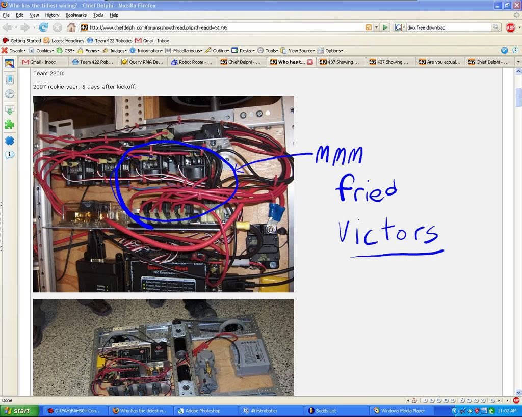

Who has the tidiest wiring?
Post a picture of what you think is the best wired robot
Team 2200:
2007 rookie year, 5 days after kickoff.
Adam Bochek - FRC 2200

You wiring is pretty tidy. But I would say you should do something about that drive shaft just floating there. You should probally put in a bearing block there.....

Re: Who has the tidyest wireing?
do you plan on driving all four wheels? Those kit wheels are pretty grippy and it doesn't look like you'll have an easy time turning.

Greg, do you know what that black (plastic?) material is in the first pic? Where do you get it? What are the specs, thickness, weight, etc.?
We have always used plywood for our electronics board because it is cheap, easy to cut and screw stuff to and also non-conductive incase someone makes a mistake and drops a screw/wire/etc. I would like to try something new and lighter this year. Does anyone have a favorite material they can recommend?

Where are the labels?

No DIN Rails?

Since you guys are not powering the front wheels, you should probably swap them out for something with less traction.
The Andymark 6" Omnis would work well.
Also, the rules aren't exactly clear, but it looks as though the DIN rails are required. Check the best practices and the electronics manual linked under section 8 of the manual on the usfirst site.
Also, those panels posted above with the white wires are 254's.
1/4" ABS Plastic is what you see there. Available pretty much anywhere. We got ours from McMaster. It is about the nicest, lightest and easiest thing we have found to work with. Everything else is either too heavy, too thick, or too ugly for our tastes.
Here are some more pictures for ideas and inspiration. There are plenty of better examples out there, too. I have always been inspired by teams 60 and 207.

We are swapping to 4wd, just waiting for the parts to arrive.

Those wires right in front of the Victor fans really worry me. With as little airflow as that last victor would get, magic smoke may make a debut.
