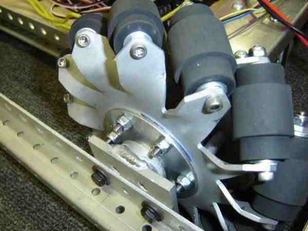

We've been working hard on the chassis and mecanum drive for the last few weeks. This is just a quick little video and some pics of the progress we have made.
This is just a video of some open loop control...We're still working on the closed loop but I think we're pretty close.

It looks like you're using a rubber offset coupling or something similar as suspension. Is that correct?
Actually we're just going to keep the frame nice and flexible this year rather than building a suspension system.
It seems to be working so far, although the real test will come once we "close the loop" either through the encoders or a gyro.
(The programmers always like it when I say stuff like that.)
We're at about 55 pounds as seen in video/photos and will be adding a lift/arm combo, pneumatics and ramp to get up to 125 pounds.

I'm not absolutely sure but I think what you are referring to as suspension is actually our optical encoders. We need them for the feedback to control our would be PID controlled drive train.
