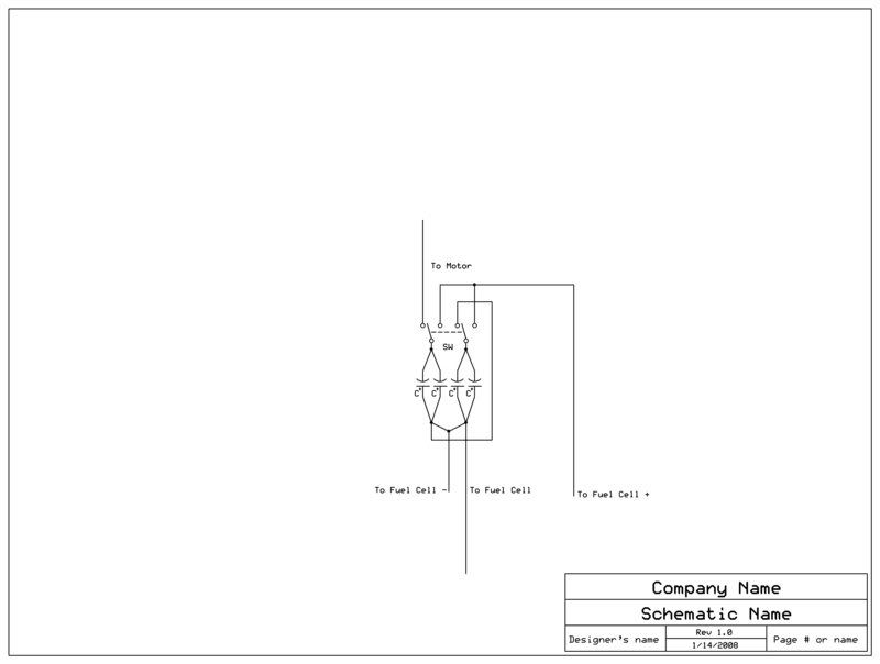

I'll be participating in another Fuel cell car race this year with the NorthEast Regional Science Bowl.
Last year, my car was the fastest primarily because I was able to use a capacitor to store the fuel cell's electricity.
Championshiop Race
First Race
I expect that next year, my opponents will be using capacitors of their own cars against me, so I need to step up my own car. My target last year was 8MPH, and I hit it exactly. This year, I wanna try and reach 20MPH. A little higher, but I think very possible.
  • Hydrogen Capacity was increased
  • Oxygen Intake and filter developed
  • New starting system which uses a push-push (on-off) set of switches.
  • Multiple capacitors in a series-parallel chain.
It's the capacitor problem which I'm having trouble getting through.
I'm chaining two 2.7v 10F capacitors in series, and getting two of those chains in parallel, for a total of 5.4V and 10F.
How do I wire those capacitors to a DPDT switch so that when the fuel cell is charging them, they are individually charging in parallel, and when armed for a race, the capacitors are in the series-parallel arrangement described above.
Any thoughts?

It is quite easy. Just wire two two pairs of two capacitors in parallel. The pairs then act as one single cap. Then it is a simple matter of switching one of the pairs to be in series with the other for normal operation and in parallel for charging. The second pole of the switch is used to switch the low side of the upper pair between the negative side of the charging circuit and the positive side of lower pair.
If you need a schematic, let me know.

Re: Circuit Design
Is this what you meant? (Sorry for the resolution)

Re: Circuit Design
Please see attached. The switch is in its "discharge" mode. And yes, I did that in Altium
What you are looking for is a standard "switched cap boost" circuit. Usually, they do this to create a supply that is (nearly) double the input voltage. This is done with a few more diodes and FETs, and fewer switches. Also, they flip the "switch" at about 100kHz (or more).
Be sure that the Fuel cell doesn't mind getting double its output voltage shoved in its face.
Tie this circuit in parallel to your battery.
Good luck!

Re: Circuit Design
The fuel cell can take up to 4V. I'm sure we can put a voltage limiter if needed.
The way I envisioned this system was to have two power sources: One from the fuel cell at ~2 volts, and one from the capacitor at ~5 volts.
When I put two batteries with uneven voltages in parallel, doesn't the load draw more current from the weaker battery?

When you put two batteries with unequal voltages in parallel, the lower voltage battery acts as large load on the higher voltage battery. The stronger battery tries to recharge the weaker one in addition to drive whatever load is placed on them. The net output voltage is somewhere between the two voltages, depending on the relative strengths of the batteries.
When the fuel cell charges the capacitors, the caps' voltage will eventually equal the maximum voltage the fuel cell can produce. If you then stack the caps in series, that will nearly double their output voltage.
Question 1: What's the output voltage and current capability of your fuel cell?
Question 2: What happens when you put the stacked (double voltage) caps across the output of the fuel cell? I think that at best the output current of the fuel cell will drop to zero, since the higher voltage of the capacitor stack will dominate the cap/fuel cell combination. You'll be driving your motors off the capacitors only, which may be okay. Worse could be that the fuel cell draws current out of the caps, away from the motors, and you get no net benefit. Worse yet is that somehow the high voltage on the output prevents the fuel cell chemical reaction from happening, hydrogen gets vented from the fuel cell near something hot (from the overvoltage at the output), and manages to ignite outside the fuel cell. I'm dangerously ignorant about the fuel cell you're using, but I've seen a few things catch fire when too much voltage is applied.
I'd suggest you first check your data sheets for what happens when your fuel cell is subject to too high a voltage on the output. Next, if explosion is unlikely, you might try to mimic the situation you're proposing with a power supply or batteries. Good luck.
Steve

Re: Circuit Design
Excellent points stj.
The Fuel Cell requires 4V to charge, and has a measured maximum discharge voltage of 2.1v. (Syringe pushing hydrogen through.) It runs well, if that's what you mean by capability. 30cc of hydrogen at room pressure can power the fuel cell for 5 min under minimal load before it chokes on the water buildup.
I don't know what happens when you introduce 5.4V into the fuel cell. It'll probably be closer to 6v. I suspect however that at that voltage, the PEM will break.
The Fuel Cell I'm using is a double-reversible fuel cell. That means it can convert electricity into hydrogen and back. You can find it here.
I don't have any data sheets for this particular fuel cell except for the specs on the website:
Power Fuel Cell: 1W
Power Electrolyzer: 2W
Active Area: 2x3 cm2
Power Supply: 3.2-4.0 V DC
HxWxL: 54 x 60x 42 mm
Weight: 70g
Attached is a schematic of the current setup. Both switches are in the Armed/race position, and both switches need to be flipped if the fuel cell is charging the capacitors.
Just curious, would I be able to isolate the fuel cell from the capacitors with some series of diodes? Because if the fuel cell creates a large load, I may need to find another way to get more power to the motor.
Team 19...Big Red
Last edited by Ronald_raygun : 19-01-2008 at 06:48. Reason: Forgot to put the picture.
