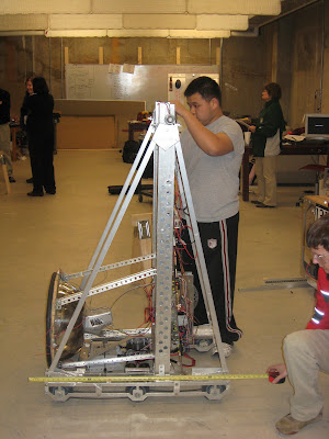

Wait, are you saying that your bot shoots the ball out of the vacuum funnel? Please explain!
We are using vacuum to ACQUIRE and to HOLD the ball. We are also using pneumatics to SHOOT the ball, all through one of these FUNNELS.

When I post pictures, I host them on a site like Photobucket or Google Picasa Web Albums.
That said, here they are:
Our robot in the starting position.

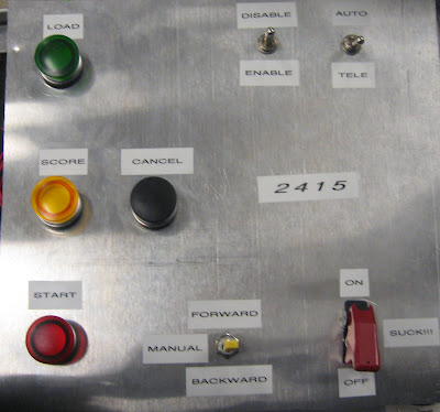

Here is our new control system for the arm. We have 3 preset positions for our arm. A cancel button incase something goes wrong(not the code). We also have a manual override for finessing the suction cup. A switch for the vacuum of course. And we also have disable and auto switches for testing.
