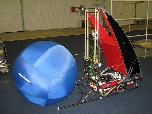

Originally Posted by rc_cola1323 View Post
Does anyone have pics of their super cool frames???
Here's a photo of Team 190's 2008 base chassis. I's not a good general all-purpose frame; rather it was highly customized for our design strategy.
http://img142.imageshack.us/img142/7225/1003436io0.jpg
It's four motor (3 CIM, one Globe), 4WD drive (two custom omni, two Colsons). It's designed to allow our robot to drive right up against a wall, then drop the rPOD to scoot sideways into it, in order to position ourselves perfectly for our "unique" trackball strategy.
