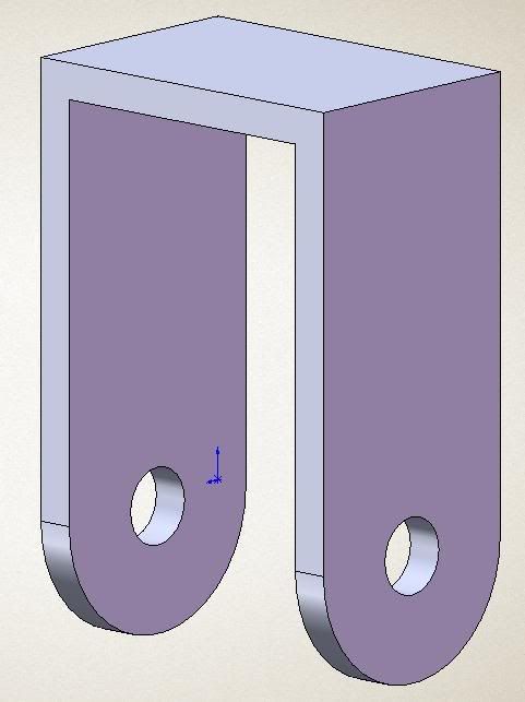

Re: New wheels / floor and encoders for position.
Originally Posted by paulcd2000 View Post
You're proposing to make a castor out of the rover wheels? that sounds legit but difficult.
not really it be really easy with a piece like this
attache the caster plate to the top and throw some encoders on it along with a giro
dimension are not exact i gust threw it together in cad
Look at a rear caster and you'll see the axle is located significantly away from the vertical axis of rotation, meaning the wheel 'trails' the vertical axle. Look up the automotive term "Caster" to see where the name came from...
