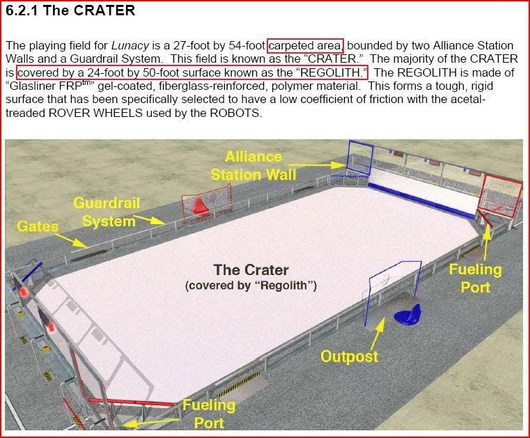

According to a clip from the competition manual, I am led to believe that the playing field is constructed with the same type of carpet as it has been over the past several years, but is simply covered by the new "regolith" (or Glasliner FRP). I have included the particular clip from Section 6 of the 2009 manual.
I hope this helps you out!
